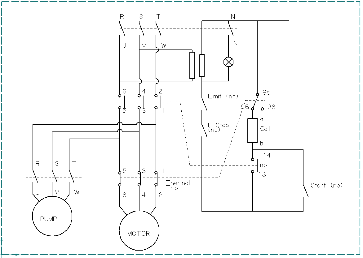

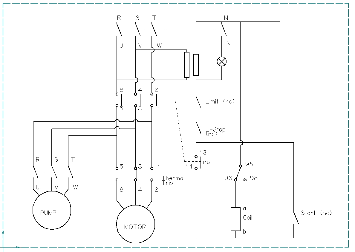

I'm in the process of re-drawing the diagram as a circuit diagram, rather than the wiring diagram you already have. This should make it easier to see how the thing actually works.
The switch top left turns power on to the saw, transformer is live.
Pushing the start button connects power from terminal 13 on contactor to terminal B. Once contactor pulls in power then flows through the contacts between terminals 13 & 14 to B holding the contactor in.
Pushing either the emergency stop button or the limit switch breaks the circuit stopping the saw.
Also main motor overload will break the circuit in an overload event.
As the coolant pump is connected after the contactor it can only be on when the saw is running.
This is how it should be - but I don't think this tallies with the last wiring diagram. I haven't put the other bits of the circuit in yet, but this should get it going. I don't see the point of using the NN contacts on the main switch to switch the indicator bulb on the transformer secondary.
