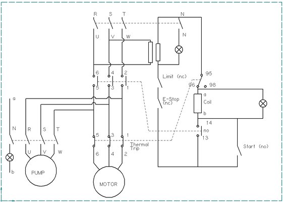

carbon, electrically 13/14 was below b on the coil.
You should never have control components both side of a contactor coil, that is very bad design and classed as dangerous in machinery control standards.
Just put all the "off" controls in the leg to a & connect b directly to one output of the control Tx, and ground that leg of the control Tx to make teh control system TN-S.
I thought that there were fuses in the control circuit, in the Tx primary & secondary?
