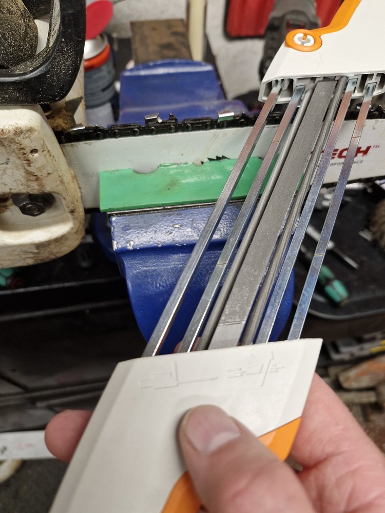

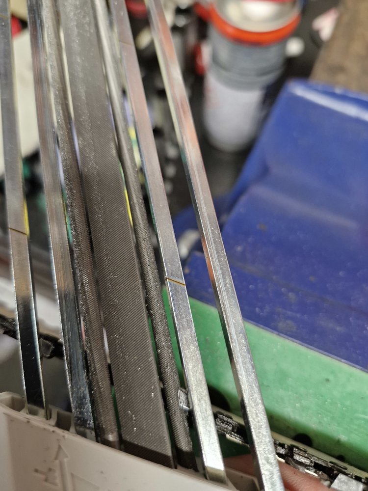

Treat them very gently , just a light kiss on the chain each time, go heavy and you'll discover all the sloppy fits and angles you don't want .It's one of these
Not much to set up wrong on them? Angle set to 30 degrees and carefully adjusted cut and depth of cut to ensure full grind on the teeth.
Don't think I'm doing anything wrong with it. I know what a sharp chain feels like and this doesn't deliver.

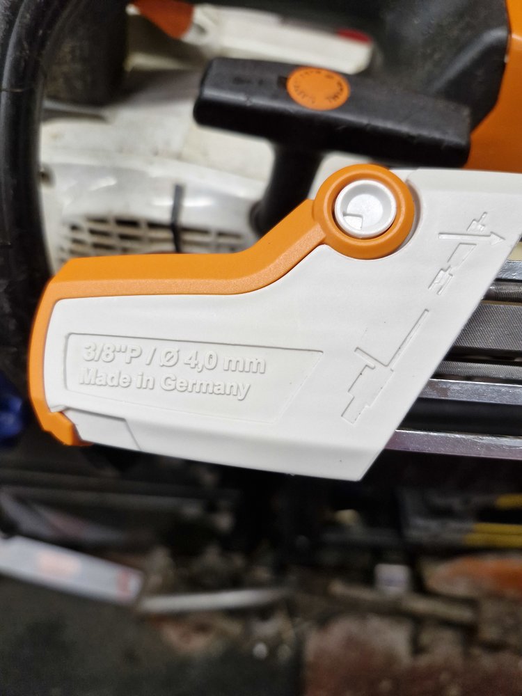

Happened to be food shopping in Lidl yesterday afternoon. lo & behold a band of angels had put an electric chainsaw chain sharpener in front of me at just the right height for me to read the specification printed on the box .
My lass saw me holding it and turning it about to get a better picture of what it was , "Go on , it's you birthday present my love " she giggled. ( roll on 21 st Dec .)
Getting home after reading th manual twice I checked the box contents to see if everything was there and it actually worked .
Even though its made of high impact plastic it is fairly precision but if you're a gorilla with hands like sledge hammers in boxing gloves it's not going to be for you , as all it needs is a gentle finger & thumb grip on the handle to advance the spinning blade into the chain , any force and the pivot points will twist out of alignment giving an inconsistent cut.

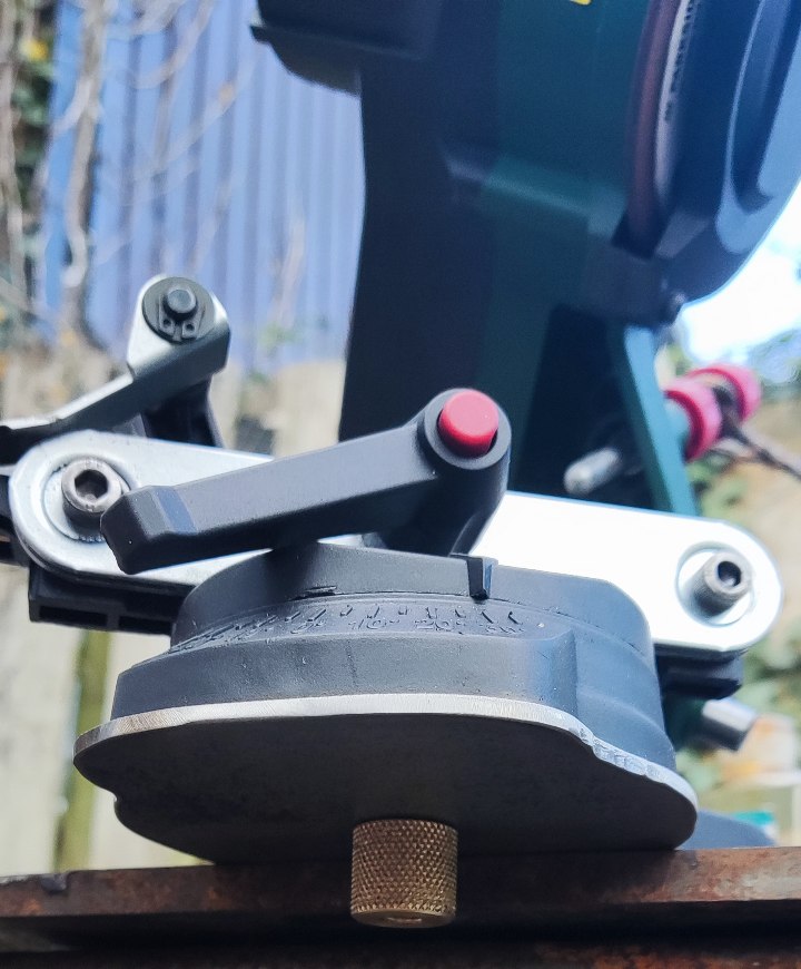

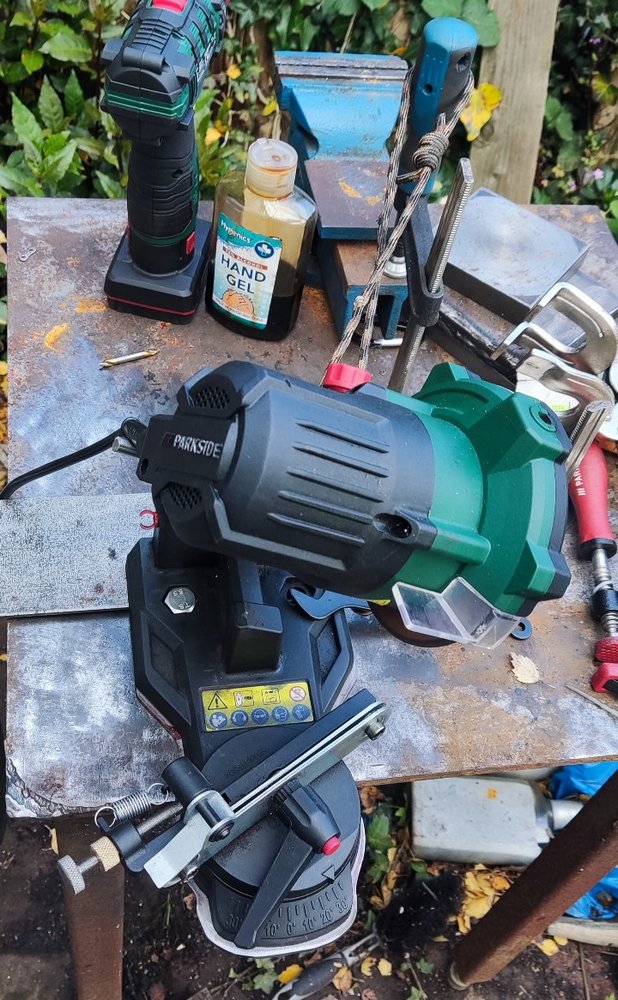

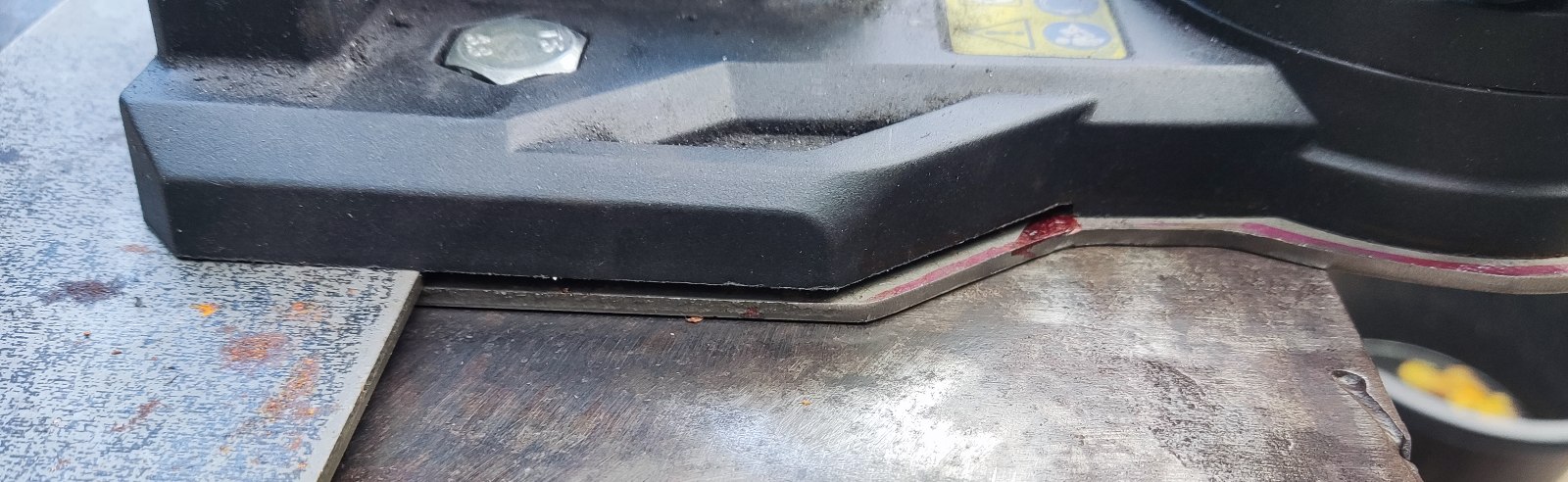

Anyway modifications continue. Annoyingly I was going to cut the shape out with plasma, but first I attacked the welding bench, back splatter burnt up the nozzle. Need more practise on thicker stuff! Couldnt find my replacement box so this was done with grinder.
Note my hold up cord as a spring replacement.
Previously replaced adjustment nut.
The step on the plastic. Easily forgotten. I will cut a proper spacer another time. It still needed the reinforcement.

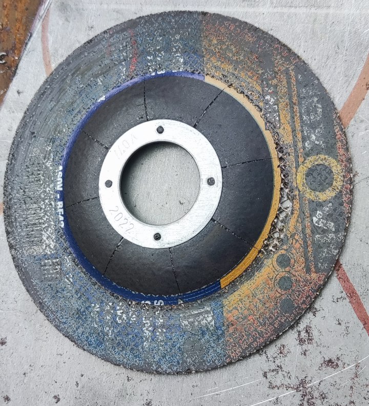

View attachment 469330Seems this grinder wheel has expired but it did the job. I never liked these depressed center ones anyway.

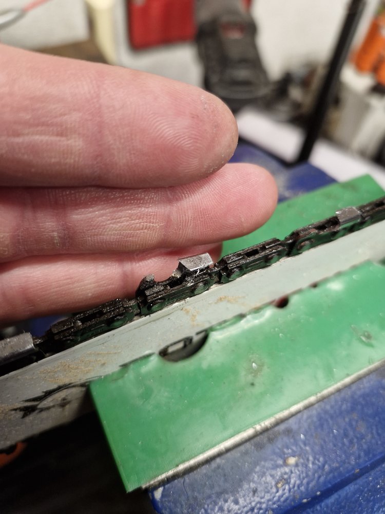

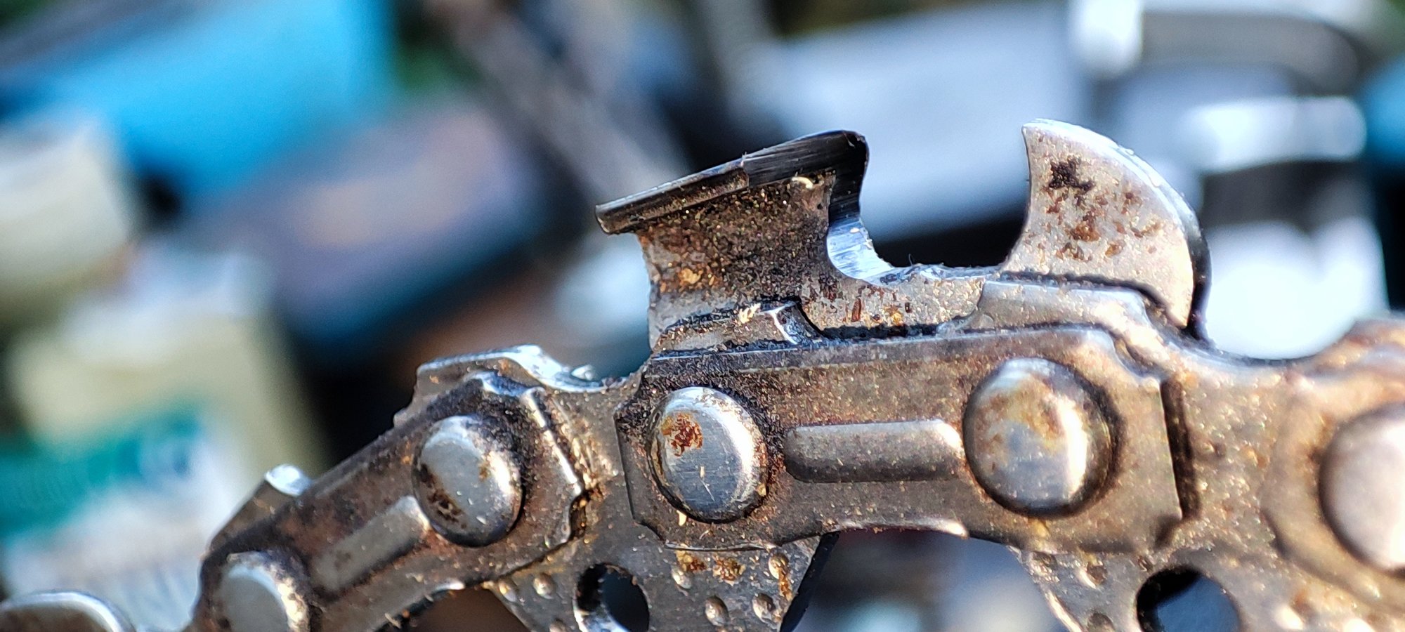

Another annoyance is that any sharpening will raise a burr in the chrome plate. The wheel spins clockwise, and on right handed cutters that grinds the burr away. On left handed cutters, the burr is pushed out. I feel its worth looking into having a reversable motor, ofcourse theres a change thenwheel nut may come loose but with a drop of threadlock will be no problem.Universal AC motors lile this are easily reversed however I'd prefer a cordless machine, wil look to see if a 775 motor can be fit in there.
One sharp chain, you can see the burr at bottom. At top I removed it with some ivy.
