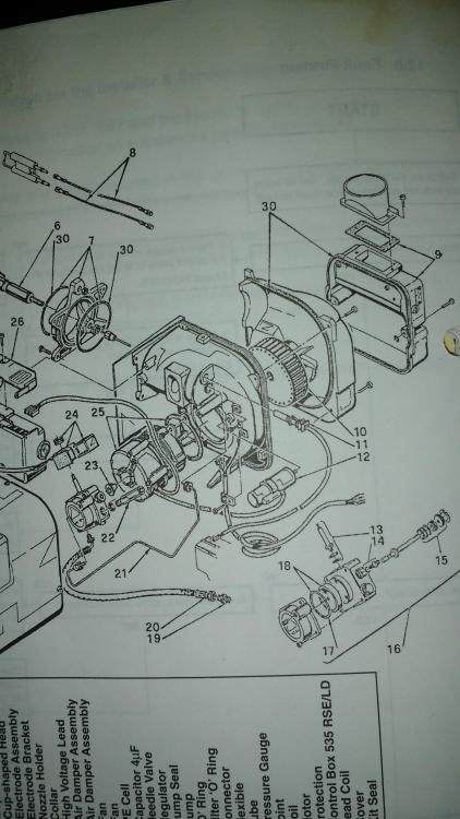

As above, I have a Grant boiler with an RDB1 Riello burner (have three actually.. but one is playing up).
It locks out intermittently. Pattern currently seems to be that it will come on, heat up the cottage to 18C when the stat cuts out and then it wont start. It has either locked at at the end of the last burn or start of the next one. Hard to know which.
So far:
- New nozzle fitted - old one looked fine tbh
- Have checked the boiler setup - pump pressure, flue gases and adjusted according to the manufacturers instructions for the nozzle, burner and boiler unit.
- The pump is about a year old so virtually new
- Boiler baffles all removed, internals cleaned and all sealed properly (its external but did have a leak before the flue from the access plate. Sealing hasn't altered the lockout)
- solenoid replaced
- photocell replaced
- oil flow seems good. Bit of gunk in the line so we disconnected both ends and blew through with a compressor
- tank was replaced last year, empty and clean so shouldnt be residual water or muck in the lines anyway
Plan tomorrow is to try the control box from an old working burner (same box as whats on there) and then try the capacitor
Stumped after that. I dont think it can be the connection between the motor and the pump as some suggest (on here and elsewhere) as it can run fine for a day or two or can cut out every time it tries to come on.
Happy to take ideas. A new burner is 'only' £330 and may be easier and cheaper at this rate!
