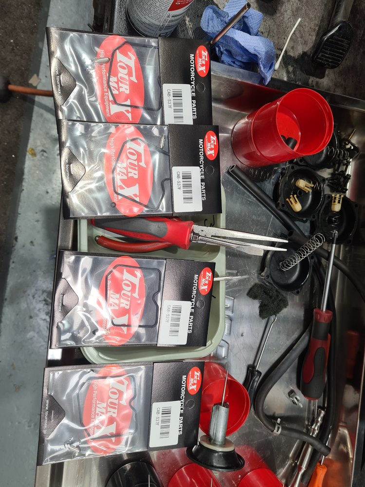

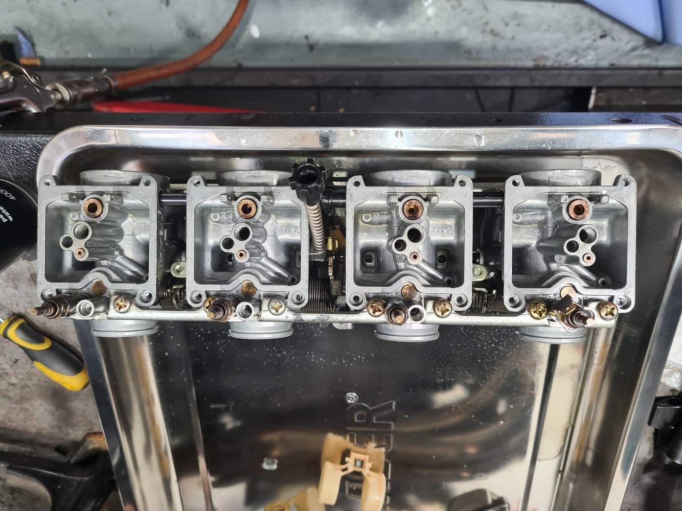

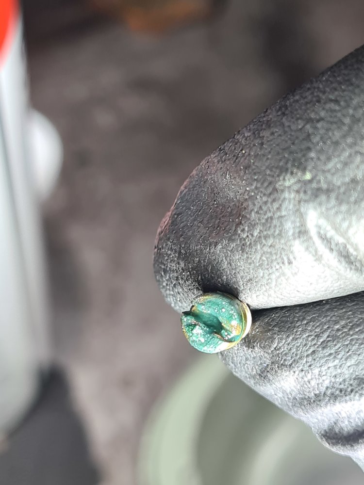

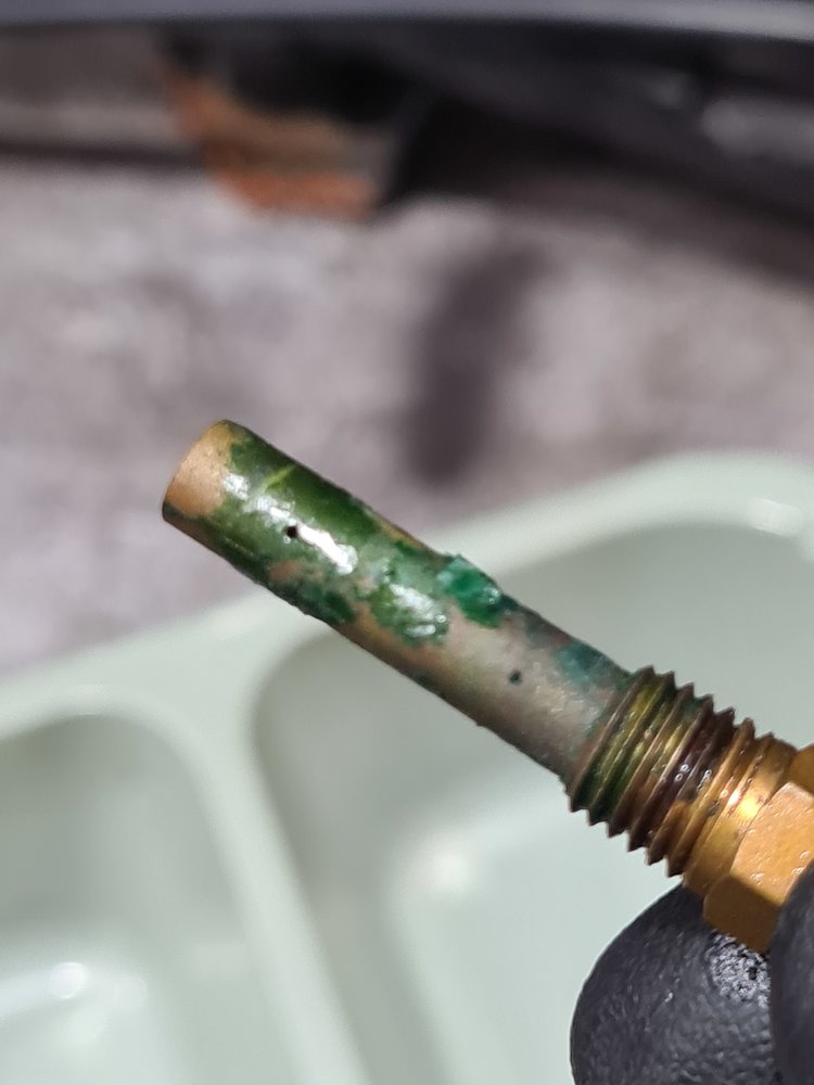

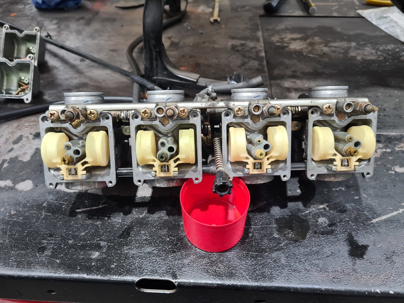

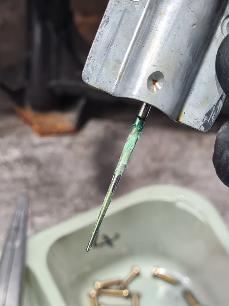

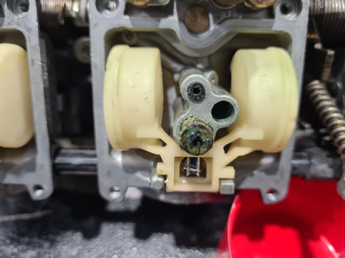

Bandit 600 came in, apparently it was running fine one month ago but someone has diagnosed spark failure as to why it doesn't run now..
Hey ho!.
Stripped and ultrasonic cleaned carbs, cleaned all jets and fitted short rebuild kits (no Keyster Kits available unfortunately).
Had to get creative with the cleaning and hand lapped some new fuel needles in.
The bike was in great condition, fuel system was a complete mess..
Personally I can't see how it was running fine a month back but what do I know?..
View attachment 456965View attachment 456966View attachment 456967View attachment 456968View attachment 456969View attachment 456970View attachment 456971View attachment 456972
I've also ordered a set of JIS screwdrivers as I don't want to mess up any carb screws.

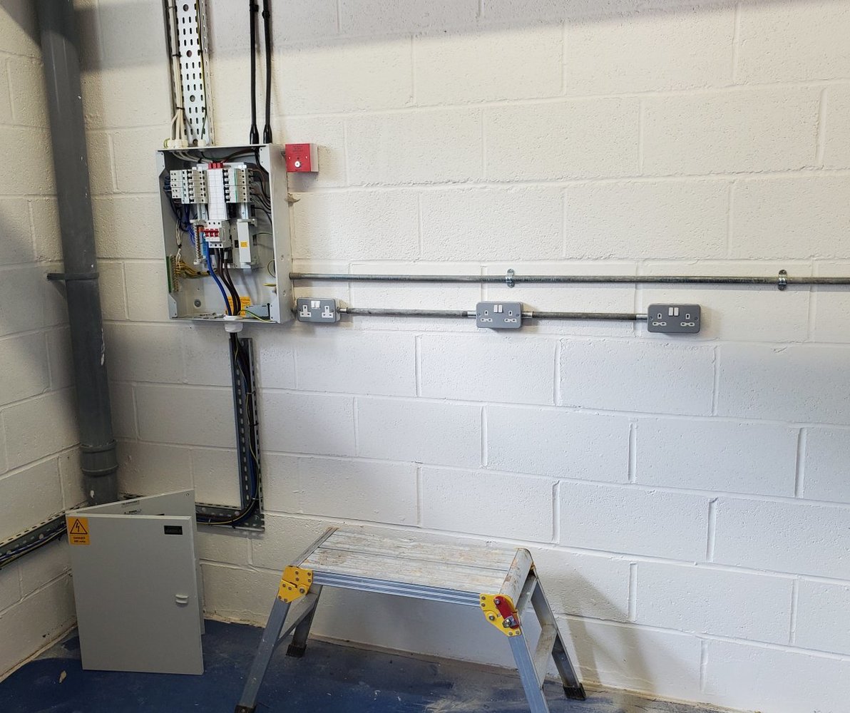

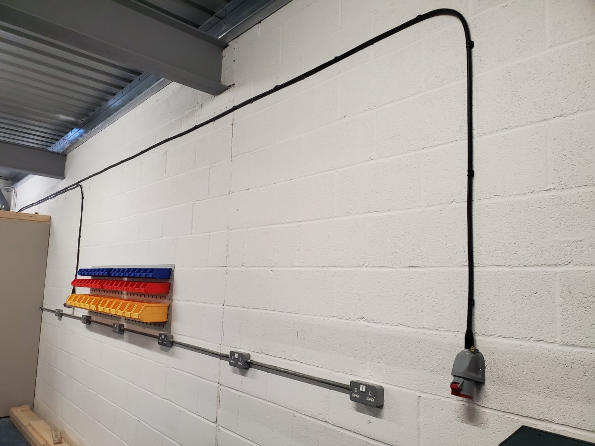

Now that's ^^^ a proper electrical service panel.The last 3 days have been spent at @Cato new unit installing a few! sockets, I think I'm getting too old for all that conduit threading

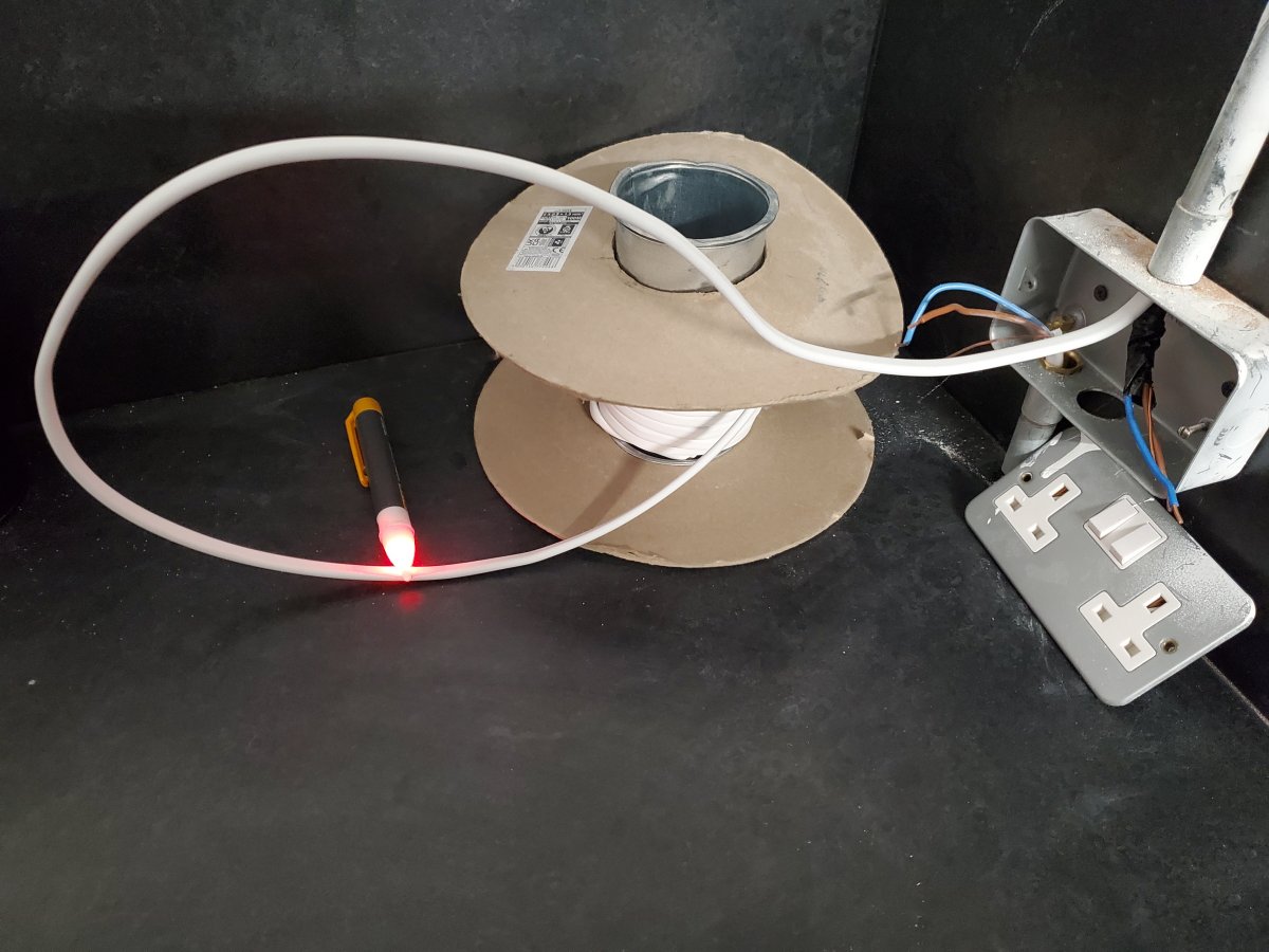

Also sorted out a few other issues that had been left such as a live roll of cable in the kitchen area.
