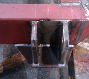

Step 1 - Pre cleaning
First any loose material needs to be removed, together with any silica on top of the weld. It is important to remove the silica, or you can get false results. A good scrape and wire brush sorts this out in most cases.
Then apply some of the cleaner to remove any oil etc. Wait for the cleaner to dry completely before applying penetrant.
Step 2 - Penetrant
Once cleaned, apply the penetrant (a bright red liquid dye). Spray plenty on the welds.
Leave the dye to penetrate, normally for about 20 minutes. The time scale is usually printed on the can or on the product data sheet. The photographs show a solvent removable system.
Step 3 - Post cleaning
Cleaning again. You need to remove excess dye from the area, which is easier said than done. It is important not to spray the cleaner on the area directly, or you risk washing the dye from the flaw.
Use a dry tissue to remove excess dye, then spray cleaner onto a clean cloth for final cleaning.
Step 4 - The results
Once it's all clean again, you need to spray on the developer, a white substance that dries slightly powdery after a few minutes. The developer draws the remaining dye from any flaws, showing them as very red marks in the brilliant white developer.
This particular test had no issues to resolve. You can see the edges of the cleaned area showing a slight redness. If there had been a hole in the weld it would have shown up very clearly as a pink-red spot.
