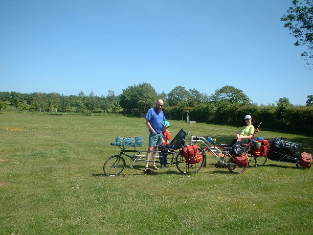

thought i'd put some pics of this little project ive just done for my daughter Sophie
we do a lot of cycling and i've had a trailer she sits in for the past 4 years, she's just about outgrown it so i decided to make a towable bike - so she can help out with the pedaling on the hills

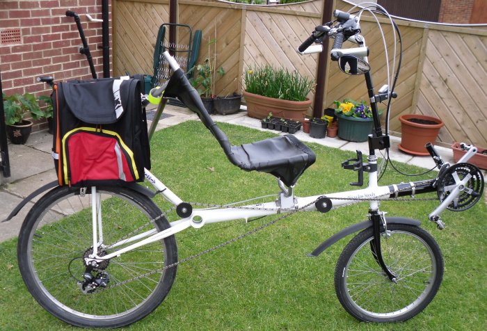

found this bike abandoned - looked an ideal donor so we took it! then cut it up a bit
extended the front bar so it attaches to my bike
the copupling is a ford transit steering linkage
then off to the shop - let sophie pick what ever colour she wanted - she chose purple
all done
got all the gears still working but i took off all the brakes - gonna add a mudguard and some bar ends (i'd hate to trap her fingers)
it works really well but i should have left more of a gap above the tyre as if you go over a steep drop it rubs on the frame would probly be ok further up the seat post but i think i'll mod it a bit
