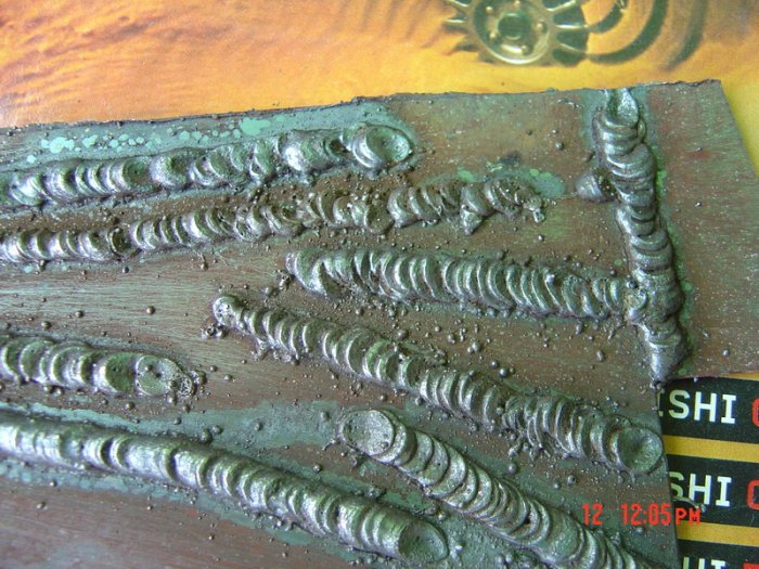

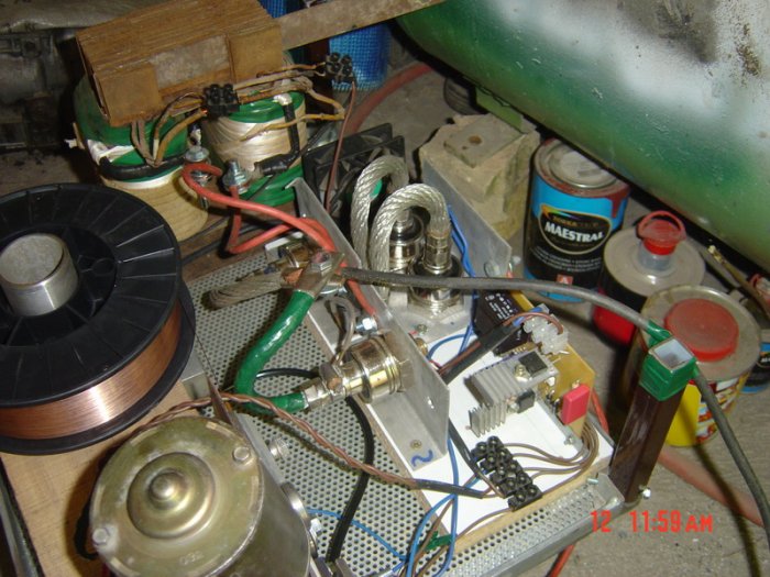

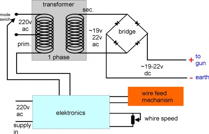

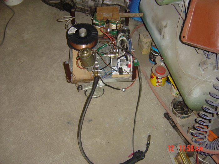

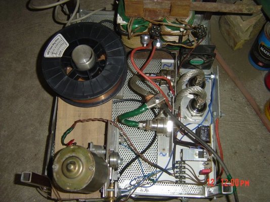

I have some parts to build my own homemade mig welder, end im finis him, here is some pictures...

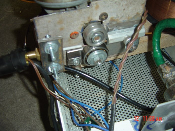

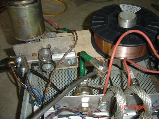

The transformers is from old rel welder, diode bridge 4x300 amp., feed mechanism is also homemade from car wash wipe /motor/.Elektronic is build my
friend and work great /tnx Deja/, only function is wire speed & burn back.
Only part from shop its gun & cable.
Voltage is 19v - 22v, curent ~30-50A, wire used 0,6

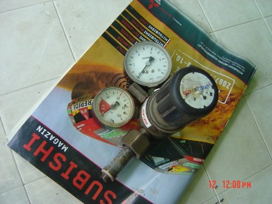

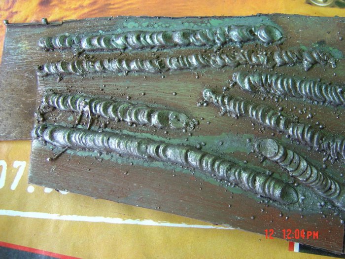

The test weld is without co2 gas, the bootle is empty, and not buy yet.
Steel plate is 1 mm...
The project is under test, well see how its work ....
