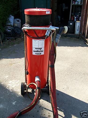

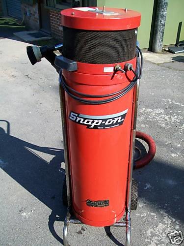

Does anyone know where I can obtain spares for the Snap on vacuum blaster YA428 ? I need a new nozzle and brush for the gun. Not had any joy from Snap on as yet.
It occurs to me that it may be made by another company who may be able to supply spares directly.
I think it's basically a sandblaster and vacuum cleaner conbined. It will be noisy and (assuming it is a syphon gun) inefficient. The combined brush & blast nozzle looks a pain to use in confined spaces.
Isn't it just a spot blaster attached to a vacuum cleaner?
I think I looked at the pic and the gun looks exactly the same as the Lectrostatic spot blaster, it wouldn't be any problem to connect a vac to a spot blaster.
I have not used the Snap on sandblaster on my car (Riley RME) as yet as I'm still waiting to hear back from the local rep. about a replacement nozzle and brush and have been busy with other things. I have however tried it and it does work but is rather slow. However, I prefer to take time rather than damage panels by using a powerful sandblaster. It is noisey but not that bad - about the same as a fairly powerful vacuum cleaner. The brush allows you to blast uneven or dimpled panels reasonably well without losing grit or causing dust. The standard brush won't go into tight corners - there is a 90 degree brush available for that.
It is essentially a spot blaster with a vacuum cleaner attached but does have the facility for separating the dust from the reclaimed grit and recirculating the grit. Hence you do not need to refill it except when the grit is worn out. The dust bucket also needs emptying when it is full.
As rtbcomp says, it is a suction gun and you need to be aware that it requires a lot of air - about 20 cfm. I have a Hydrovane 23 compressor running off a phase converter that delivers this sort of cfm at about 80 to 100 psi. I wouldn't want to try to use it with a smaller compressor as you would have to keep waiting for the compressor's air receiver to get back up to pressure and this would make a slow job even slower.
If you are thinking of getting one then I would suggest you keep a look out on ebay, which is how I got mine. Hopefully you will be able to go and see how well it works before bidding. This should be very much cheaper than a new one from Snap on.
