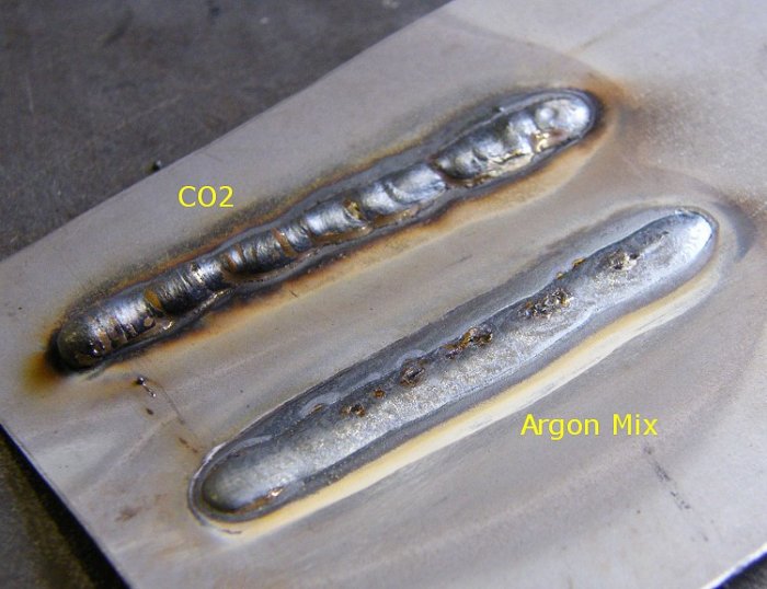

BChild came over this afternoon for a little welding and brought his Cosmo 170 running CO2. We started off on 2mm sheet and all went well, but moving to 0.8mm we discovered a big problem with CO2. The welder didn't work on the bottom power setting at all - it would lay weld on top of the metal with no penetration, and it was impossible to adjust the wire speed to give a consistent weld.
Second lowest power setting worked intermittently. It would sometimes lay weld on top of the steel and sometimes weld OK (and then blow holes - 2nd setting is not good for 0.8mm sheet). After scratching of heads we connected Argoshield to the Cosmo. That made it work. It'll be the Cosmo thought I, so we connected the CO2 bottle to my Portamig 181. Exactly the same problem!
See the photo comparing CO2 and Argoshield on the Portamig. Same settings used. A video would have been better as the metal transfer modes seemed very different - CO2 just wasn't working. BChild has an identical looking coupon done with the Cosmo.
Anyone who has compared the gasses will know the arc is less stable with CO2, but it seems it doesn't work at all for low voltages (thin metal welding). Presumably not enough voltage on the lowest settings for a workable arc. It seemed to not arc until the wire touched the work, then it burned back and the process repeated. Not anything like welding.
From 1.5mm steel upwards, and maybe 1.2mm at a pinch, CO2 works, not as neat or as smooth perhaps, but more economical. For anyone using CO2 and having trouble with their lowest power settings it's very possible the gas is your trouble.
I'll update the gas comparison page (did that work on 1.5mm sheet and didn't notice this problem).
