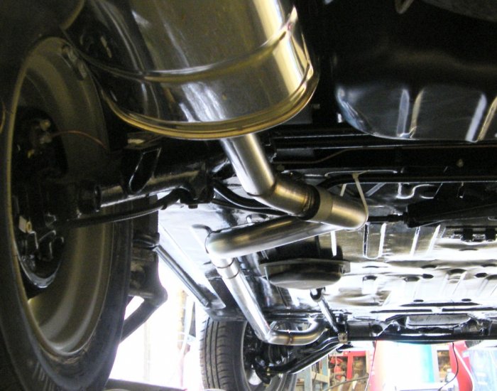

I'm slowly building an exhaust for my Renault from pre-bent pipes. Wouldn't have posted anything on the forum but Si seemed very keen to see some photos, and it could be of use to others who have accidentally fitted the wrong engine to their car.
The bits

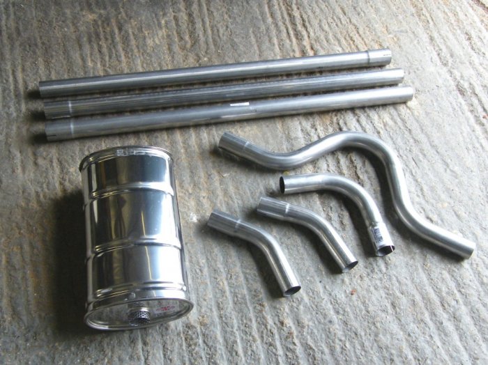

Impossible to find at first, but you guys helped. Here's a pic of the bits:
The front bit

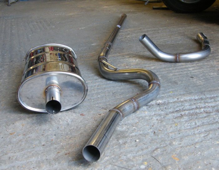

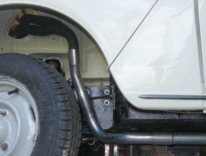

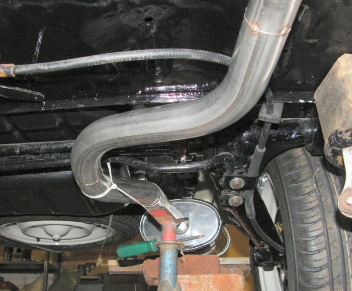

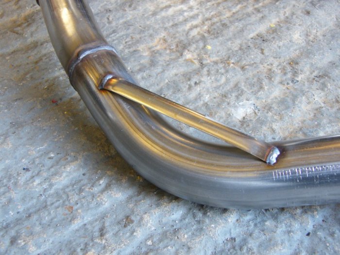

I started a bit late in the weekend and have since been inundated with visitors. I'm going from front to rear. Just cutting bits and tacking them together at the moment. The front bit (weird shape as the exhaust is in the wheelarch and I need to clear the wheel) is tacked together. I'm nearly there at the back - should have everything at least tacked up tomorrow.
Here's a pic (the Jetex bends are quite handy - mandrel bent and have sleeves that fit over the next pipe if you fancy a joint. I'll mostly be butt welding and the sleeves have been cut off, but there will be at least 2 joints in the system):
More tomorrow.

,did you get the box from a different place to the jetex pipes ?....do you mind sharing how much it all cost?

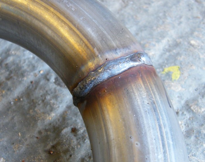

.......i do wonder if purging is overkill on an exhaust though?....great for food industry but would an exhaust last 10+years if you didn't? seen vac pipes and process pipes which haven't been purged put in service but i have not seen any fail yet ?
