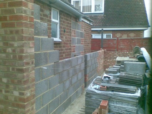

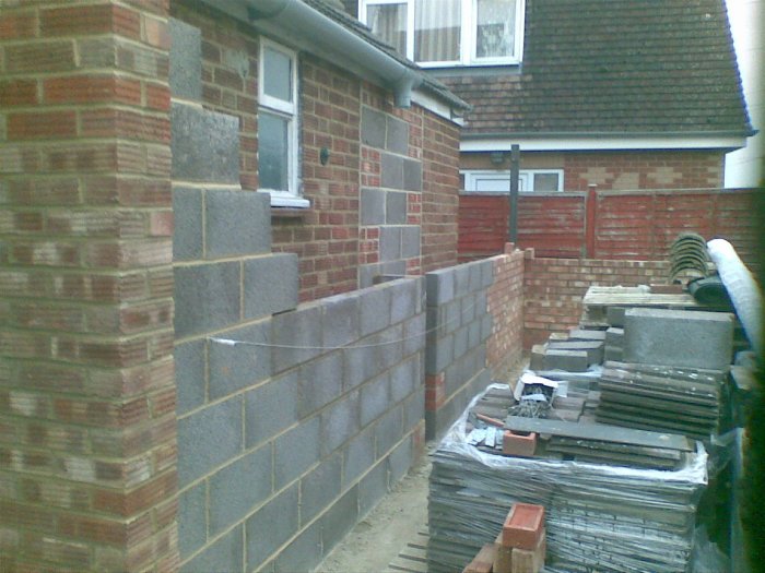

these hollow blocks are going to form the new retainng wall and they're going to have the rebar tied through them, to bind the footing, the wall and the concrete base all together
the shorter sections of the smooth rebar are going to be used to tie the 3 slab pours of the concrete base together. The 3 slabs have an expansion joint btween them and these steel dowels join 2 adjacent slabs together. The black rubber sleeves you can just make out are used so that the dowels can move slightly as the pad expands/contracts

made some good progress today, i managed to pour the car lift base., fingers crossed none of the 47 bastard neigbourhood cats get in it!!! i've already had my cat run through it once :angry:

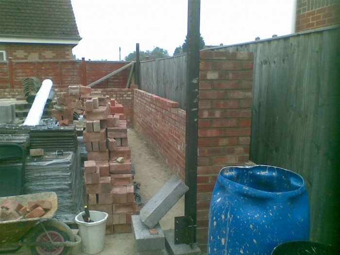

The first job was to repair some of the large wall capping flagstones on the right hand wall that had been loosened when the roof of the carport came crashing down. When it came down the uprights which were bolted to several of the flagstones pulled the flagstones loose. So i had to chip away the old bonding cement/mortar and re-mortar the flags to the wall.
Once that was done it was then onto building the single course of bricks on top of the wall. The wooden frame of the workshop will then sit on this.
Anyway it took me most of the afternoon to lay the bricks as I've never done it before but i took my time and it seemed to all work out OK. After about 10 or so bricks i got into a little rhythm which helped.
Here's a few pics of the progress
