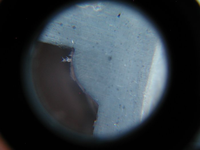

I'm doing an evening course in the UK refreshing my stick welding, which has gone rusty through lack of use. Two of the test pieces have a vertical fillet (T-joint and lap on mild steel 6mm plate).
The college provides 2.4mm E6013 rods and the machine's a Citoarc (Oerlikon) welding DCRP (electrode positive).
I'm finding it difficult to get a good penetration/fusion stringer bead right in the corner of the joint: penetration is low and a very small bead of slag/porosity seems to get trapped right in the weld root so that when a small section is cut out for destructive testing, there's no/inadequate penetration along the root edge - i.e.no fusion at the root. (See photo)
Given a choice, I'd try putting the root run in with a 6011 electrode as it'd be deeper penetrating and there's far less slag to get forced into the root; however, I'd like to solve this problem with the 6013.
I've found that the best results are with a vertical-up run with the electrode trailing slightly i.e.a slope angle of 95 to 100 degrees. I guess this is because the slag is forced away from the root rather than into it. On the other hand, a leading electrode angle always shows a pinhole at the root when the specimen is sectioned.
I haven't yet tried laying the root run with a vertical down run, which, again, should stop the slag being forced ahead of the weld pool. But before I give that a go, I'd appreciate any advice from this forum.
Many thanks
Martin
