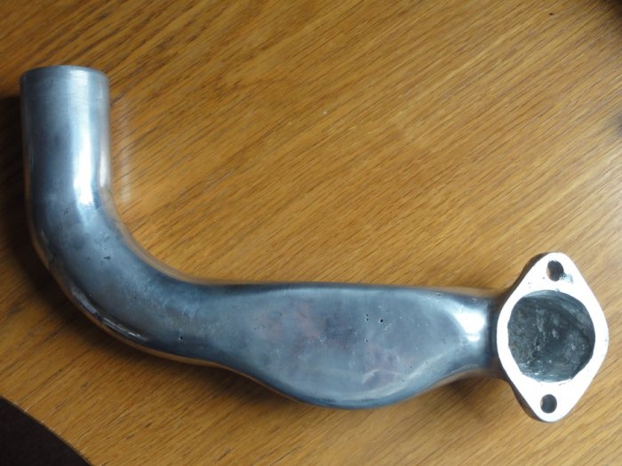

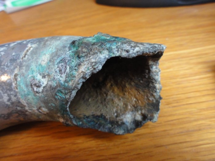

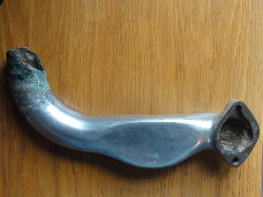

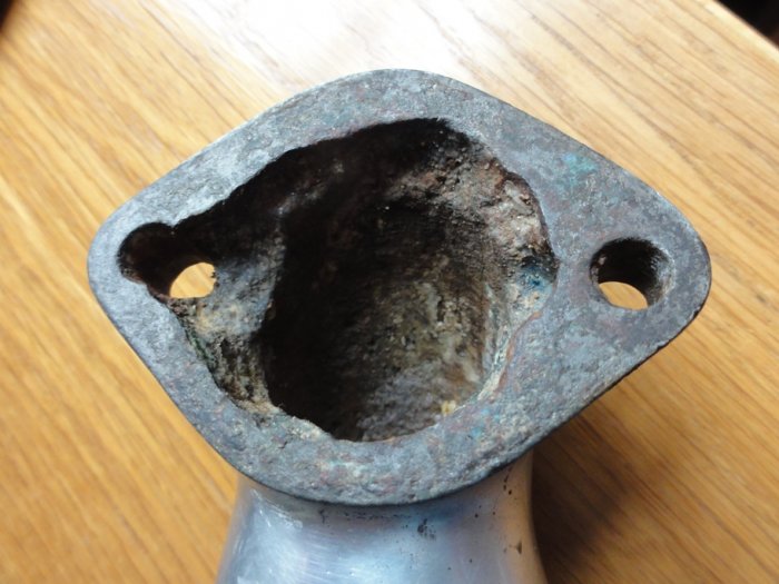

I have been suffering a steady loss of coolant from my 1934 Alvis, and tracked it down to the lower radiator hose connecting pipe. When I removed it, I was amazed it held any coolant at all -it looks like the car has been run at some time without inhibitor, and the aluminium pipe has suffered catastrophic electrolytic corrosion. The flange has been eaten away at one end, and the hose attachment at the other.
The rest of the pipe seems to be in fair condition, so can anybody suggest someone who is skilled with a TIG welder, preferably near Cambridge, who could have a go at repairing it for me?
