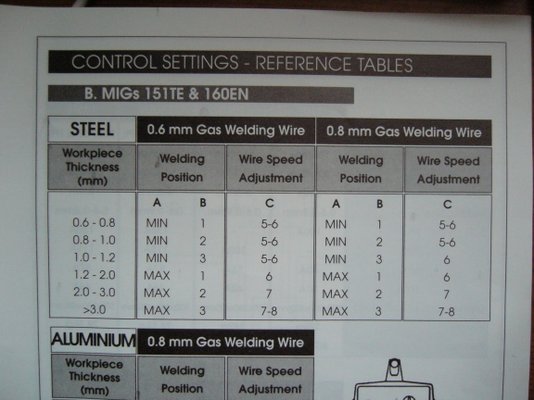

I've seen lots of posts on here about Clarke power settings and wasn't sure about my 151TE as i've not really used it on anything except 3-MAX!! I have attached the page from the manual which says it goes 1-MIN, 2-MIN etc...however I checked it with a volt meter and it DOES go:
1-MIN
1-MAX
2-MIN
2-MAX
3-MIN
3-MAX
So there you go! You can check your own with a voltmeter (nothing special), I flipped the tentioner off on the wire feed to stop it feeding metres of wire out while I did this. Of course yours might actually be different.
