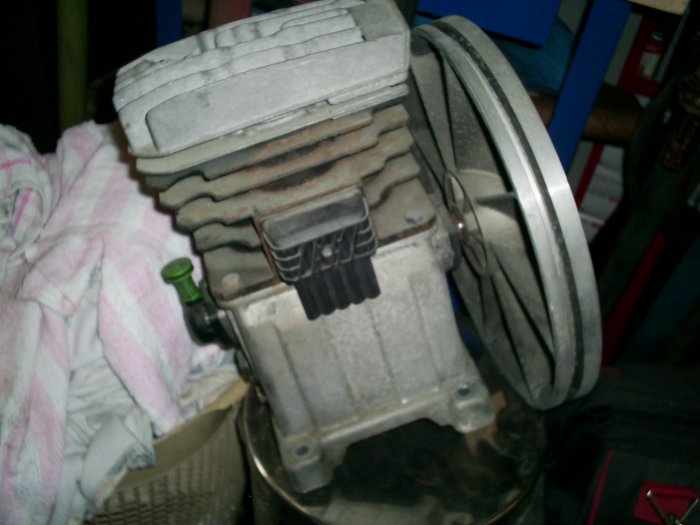

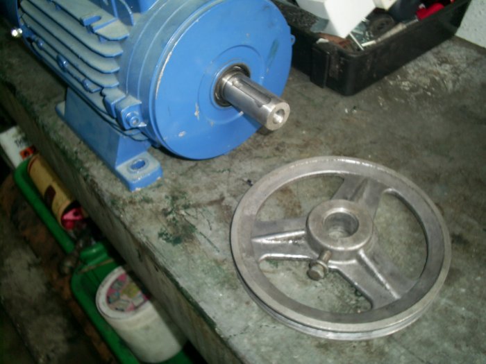

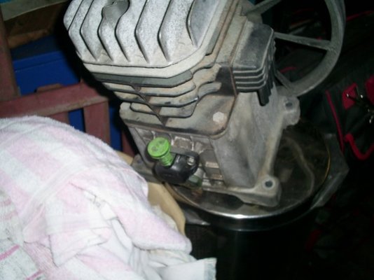

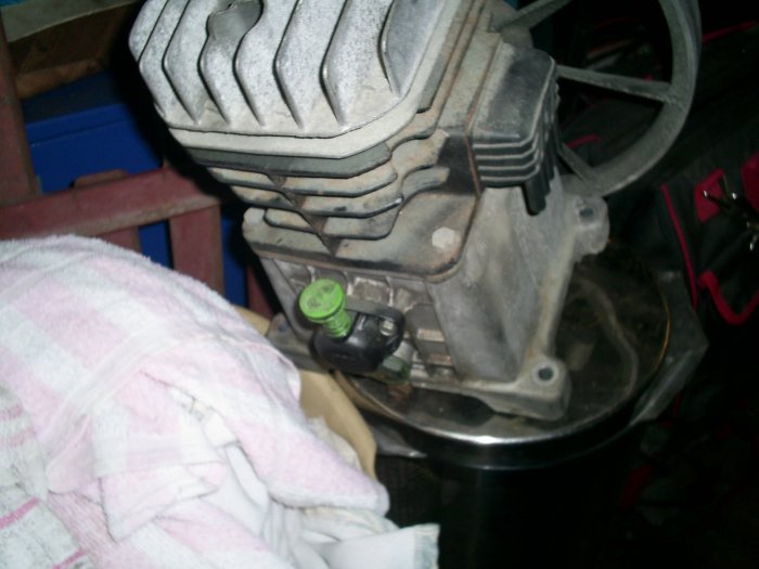

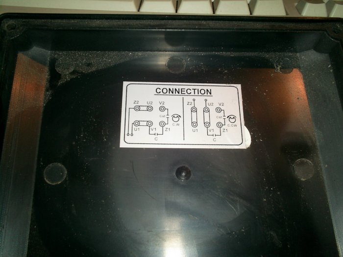

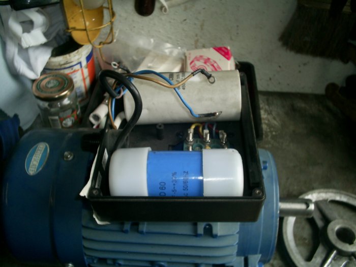

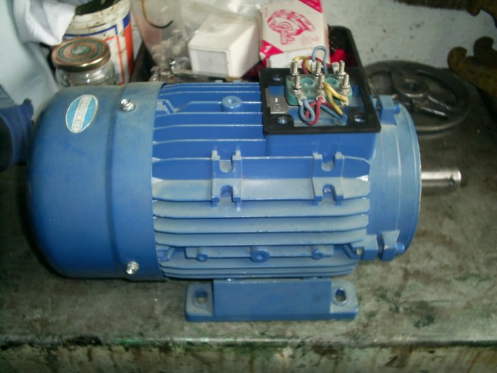

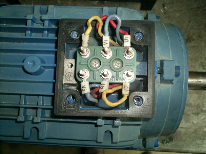

I managed to pick up a pump,motor,guard and pulleys at an auction. Its a good sized pump and a hefty motor. There are no data plates on either so i do not know the size/output figures. I thought I would check the motor out so I connected it with a plug and cable and plugged it in to see if it worked. The cb tripped. So I set about doing basic checks(I am not an electrician but am an ex aircraft engineer and so have a working basic knowledge of the mysterious force). I first checked the capacitors using a multi meter IAW a procedure I found on google. Basically it said to select a high resistance range then connect the leads and if the caps are ok you should see the meter rising towards infinity as the caps charge from the meters battery. They both did. Ones a start cap and one is the main cap. (One of the attached photos shows the wiring setup on the electrical boxes cover.) The next thing I did was remove the caps and links which allow the rotation to be changed so that all I had to play with was the terminal block with the 6 connections. 2 each of red, yellow and blue wires. I then did a continuity check first of each coloured pair. They all showed a circuit. I then checked each post against all other posts. The wires connected to the terminals marked z1 and u1 showed continuity. In my mind this is wrong and is causing my problem but IS IT?? Terminal z1 has a yellow wire to it and terminal u1 has a red wire to it.
Can anybody steer me on the correct path?
Regards, Michael T
Regards, Michael T
