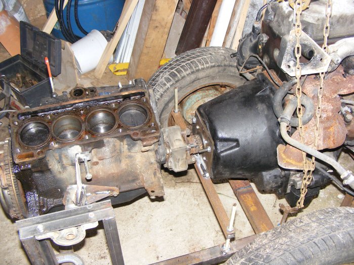

So, I scrapped the trusty Ford P100 and mounted the 1.8TD engine in a frame. The first motion shaft has a yoke welded to it for the rotor-flex rubber coupling that was in the prop-shaft, clutch is functional.
The Renault 1250cc engine is driven off the pulley end, via the coupling, to keep correct rotation for the oil pump.

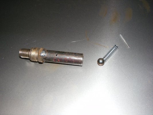

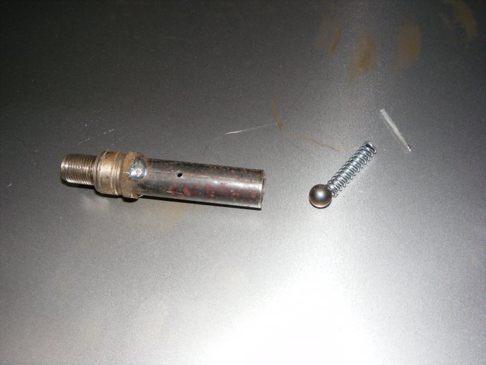

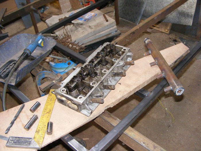

Spark plugs were converted to NRVs as in one of the pics, the manifold will be be joined with rubber tube and has a big blow-off valve at one end and
1" BSP at the other.
Now, I will run it up this week end with the inlets acting in 4-stroke mode, so half capacity. But I have half built some bits to get the inlets to open on every down stroke. Essentially linking the rockers so that the valves work in pairs. When either push rod opens a valve, the other also opens. Not too tricky for the middle two cylinders, touch more so for the outers.

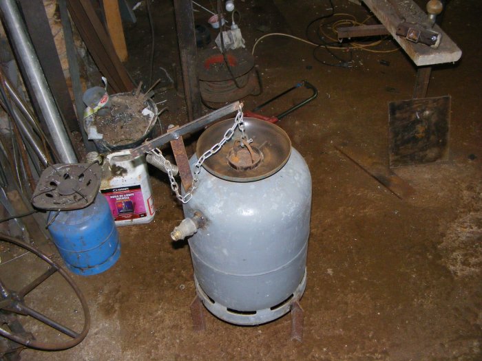

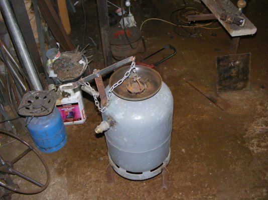

I built the pot a while back out of a gas bottle and will put up a pic later today.

Edit: Seems the server didn't upload the pix, will try again.
