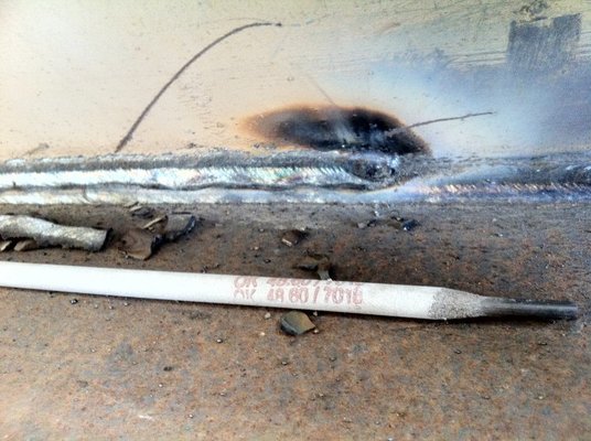

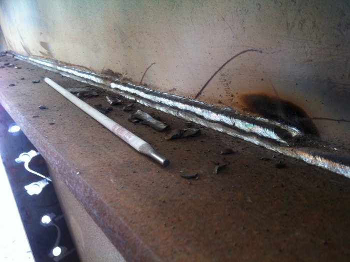

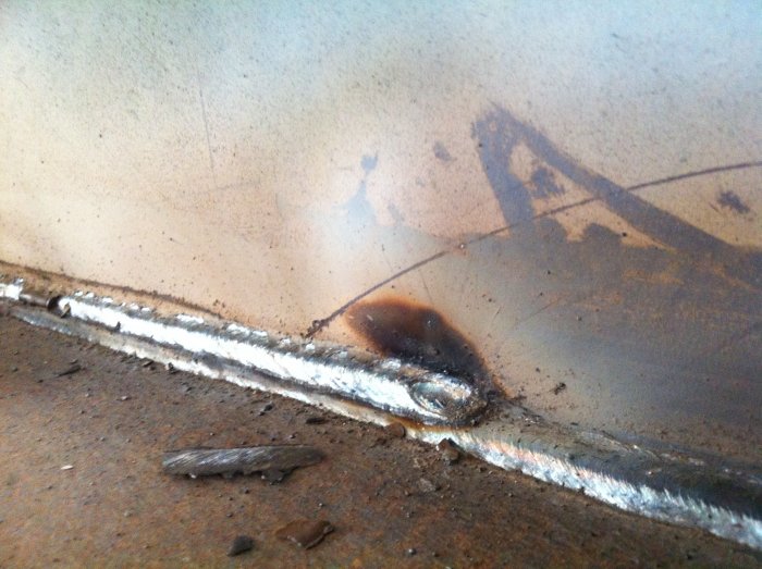

, surprised to see so much weld at the haunch web to flange connection, quite often we weld these 100mm one side then 100mm other side staggered. was this specced from engineers details or have you guessed more is better? 10/12mm FW to a 6-8mm web is a bit over the top.how do u know its an 8mm web as its such a deep section-looks @ least a 356mm ? Neat fillets anyway.those welds look dreadful, grind out and start again
nice drop of welding there, surprised to see so much weld at the haunch web to flange connection, quite often we weld these 100mm one side then 100mm other side staggered. was this specced from engineers details or have you guessed more is better? 10/12mm FW to a 6-8mm web is a bit over the top.
show us a pic of the endplate welds please
