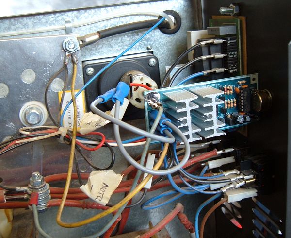

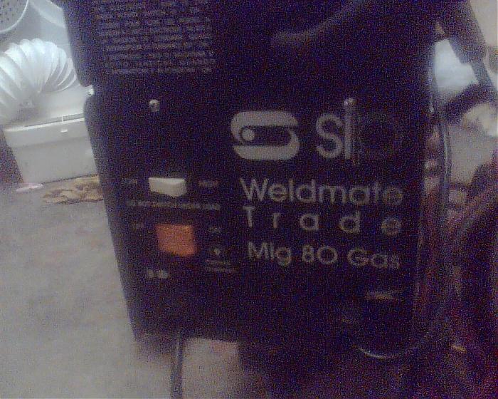

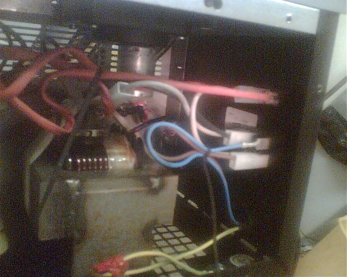

I fitted that pulse width modulation (PWM) wire controllor (bought from eBay - search 30 amp motor controller) to the SIP 130. It comes with it's own circuit board and is a fairly direct swap out for the wire feed circuit on a PCB.
My worry was the choice of inputs are 12V or 24V (select via a jumper) and I wanted the wire speed to change with power setting which maybe varies from somewhere like 13V to 22V.
Plugged it in across the torch and earth anyway and it works (for now at any rate)!
You'd expect more low speed torque from a PWM controller, or so I'm led to believe.
It doesn't make a lot of difference to the ease of welding. Possibly the starting is slightly quicker on the lowest setting, but there's no real improvement to the jerkiness. Would probably need the smoothing transformer for that.

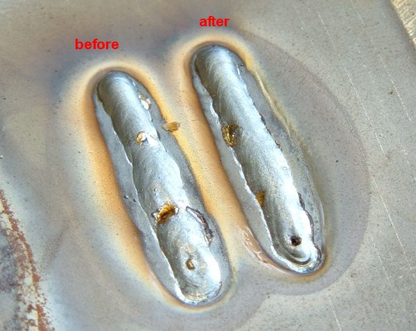

Here are before and after welds on the lowest setting on 0.8mm sheet with argoshield (thanks for the adapter weldequip):
In summary there doesn't appear to be any real advantage to doing this mod.
One thought - I never find the lowest settings of these mig welders quite low enough for 0.8mm. Would it be possible to fit a step down transformer after the main transformer? Or would that create nasty resonances in the electrics?

What
the wire speed knob is sensative but ive got used to it tbh -but you could put a bigger knob on it to increase the finger travel (increased circumference) for the same ajdustment
