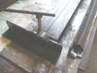

horrible weather today, hammering down with rain most of the time, so I decided to get stuck in and make a metal folder using a combination of drawings/plans from here and other places. I've been gathering bits of angle for a few days but the hinges were giving me some problems as I couldn't find anything suitable, the big hinges on Welderpauls folder looked best but what could I use?.
Then I found a piece of caravan jockey wheel that I'd cut up some time ago and discovered that it's one solid piece of metal inside a 'tube', and by cutting two pieces 2cm wide, I'd got the hinges...

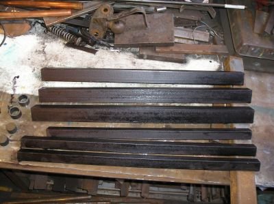

So I cut the six pieces of angle to 23", the length of the shortest piece, scraped off the rust and applied Kurust...
Then I started joining the smaller angles inside the larger ones to form box sections...

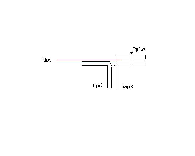

The two main parts were done as a 'box', but I decided to make the top plate with the upright of the angle at the back, and the smaller angle would then form a triangular cross section so I could get more than 90 degrees bend on the plate. It's sort of a 'L' with a '^' welded on the bottom leg. The top plate in at the font of the bench in the next photo.

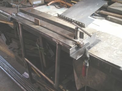

The screw down pins for the top plate are a couple of 10 x 75mm bolts with a bit of rod welded to the top. The spacers are washers with a 5 cm piece of tube in between. This shows the almost finished folder, with another piece of angle at each end to hold it all together, to give stability and clamping plates. I used the plasma to cut out the semi-circles for the hinge tube.
The handle is just three bits of tube welded up and attached...got this in the wrong 'plane' initially, I had it pointing straight out instead of down! But a bit of cutting and grinding got it sorted.
I tried a piece of dexion first, 1mm thick, no problem. Next I tried a bit of 3mm and it managed that too. The maximum angle is only 95 degrees at the moment so I may have to do a bit more grinding on the front of the top plate if I need to go any further.
