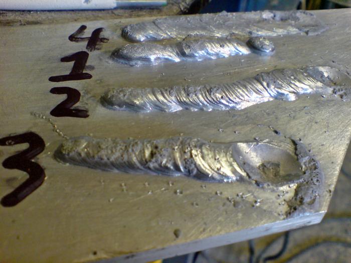

hey, is there such a thing as a arc welding rod to weld aluminum, I know with mig you must use argon gas, but is there anything for arc, my welder is a ac or dc current high, low settings and its 295 amps 230 volt, thanks

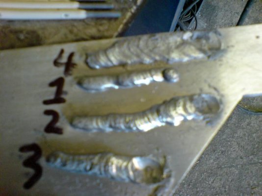

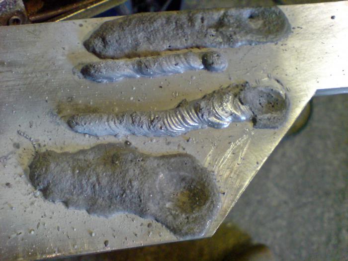

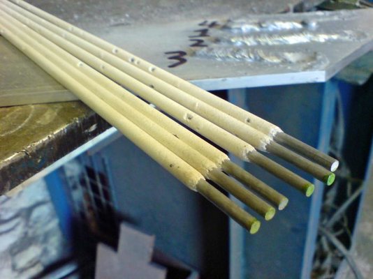

I have welded lots of alum with 1/8" stick rod. It is best used on thicker castings and with DCEP which is DC reverse poliarity.
Royal 300 Extruded Coated Aluminum Electrode (DC Reverse) http://www.crownalloys.com/page06.pdf
..Bob
What set did you run it on? they should be run on dc positive around 85amps with the the electrode held vertical with a short arc to clean the weld you can use a 10% caustic soda solution, the electrode contains 12% silicon, ex stubbs welding rep those where the days!
