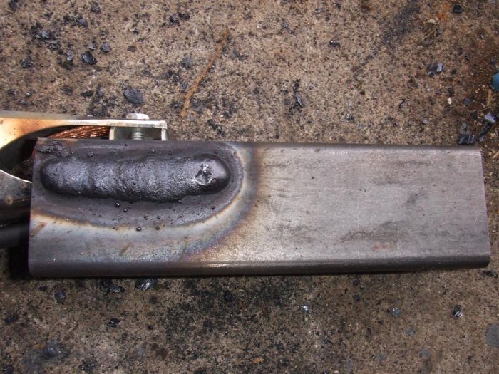

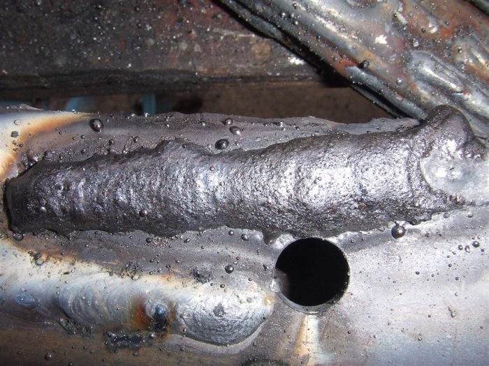

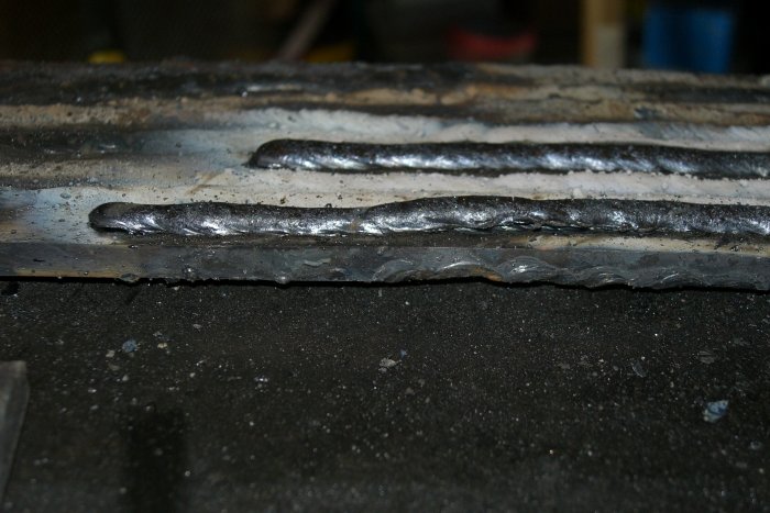

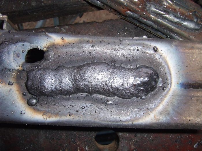

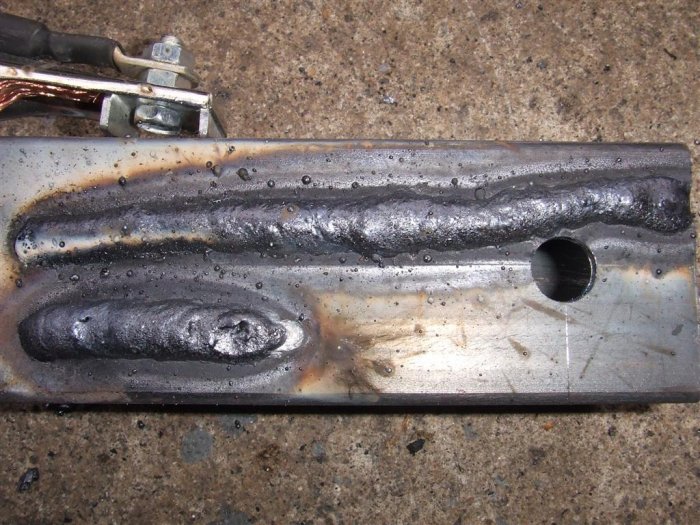

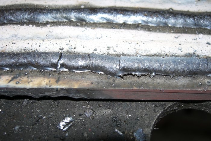

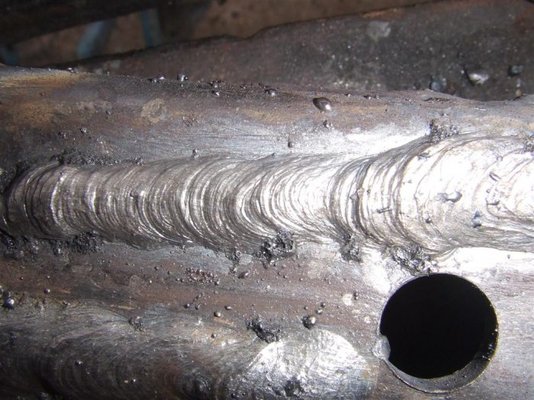

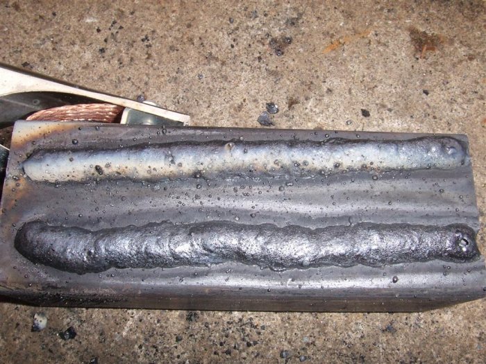

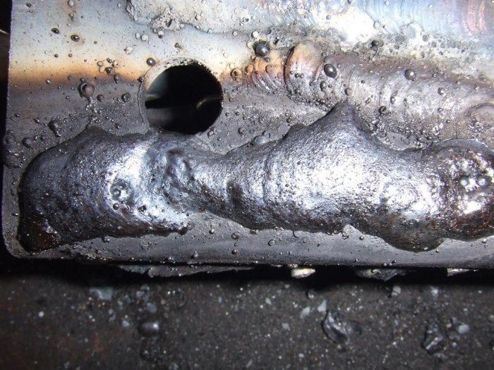

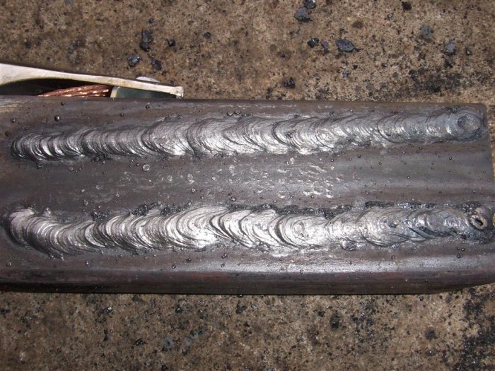

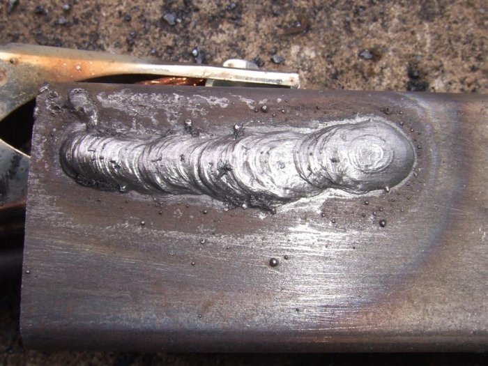

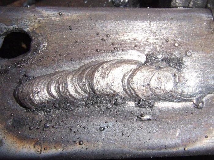

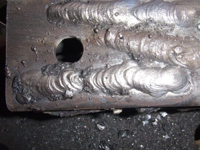

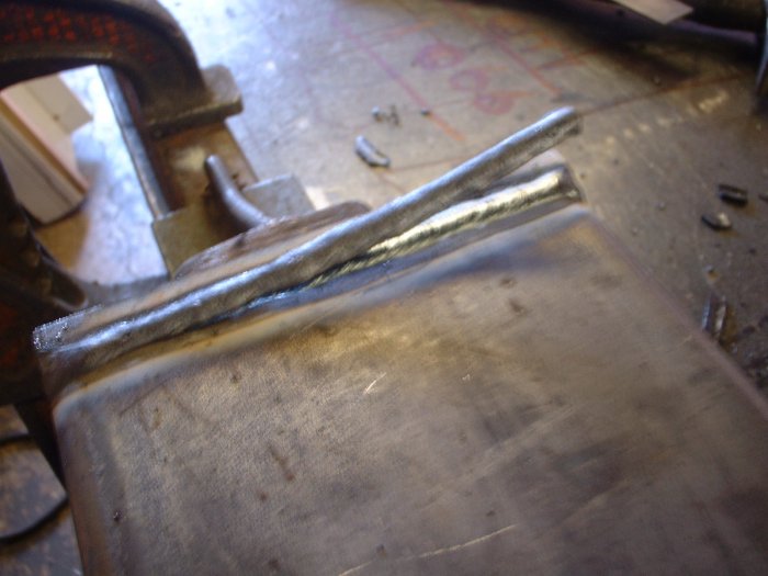

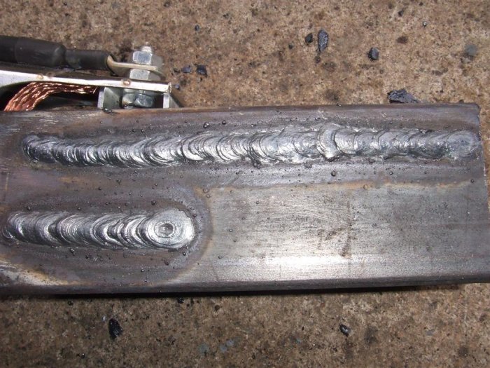

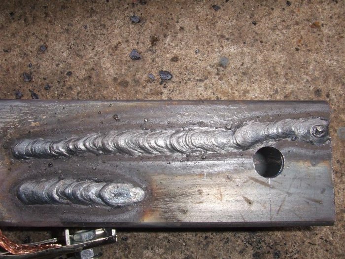

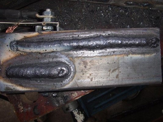

I have had a chance today to play with my Aldi arc welder that is currently on offer in their stores.
The following pics were using 80 amps, 2.5mm 6013 rods on 3mm thick 50mm box section. All help and constructive criticism is appreciated. The rods are Aldi specials too and branded powercraft as is the welder. Needless to say I need a lot more practice.
Prior to this, the only arc experience I've had is about an hour on a mate's welder a few months back. It was a Wolf model also of 160 amp capacity but its about twice the size of the current Aldi offering. I think wolf/powercraft/omega are the same company.
From memory I found it much easier to maintain an arc with his welder compared to mine Mine also makes a hell of a racket and the case vibrates much more.
It looks to me like I'm traveling too fast. The best bit on there would seem to me to be the first third of the bottom run on the second set of images. At this point the rod was only about three inches or so long so it was easier to control.
I had a go with the 2mm rods on the suggested power setting for the welder on 2mm box section but I had real trouble trying to get them to strike and maintain an arc and I gave up.I would particulary welcome suggestions for power settings and rod diameters for different thicknesses of metal from anyone else with a similar welder.I found it a bit of a stuggle to maintain the arc but it did seem to improve as I practiced even if the resultant weld didn't seem to get any better.
I think flange jockey's job is still safe for the time being
I smell like a bonfire now as well
