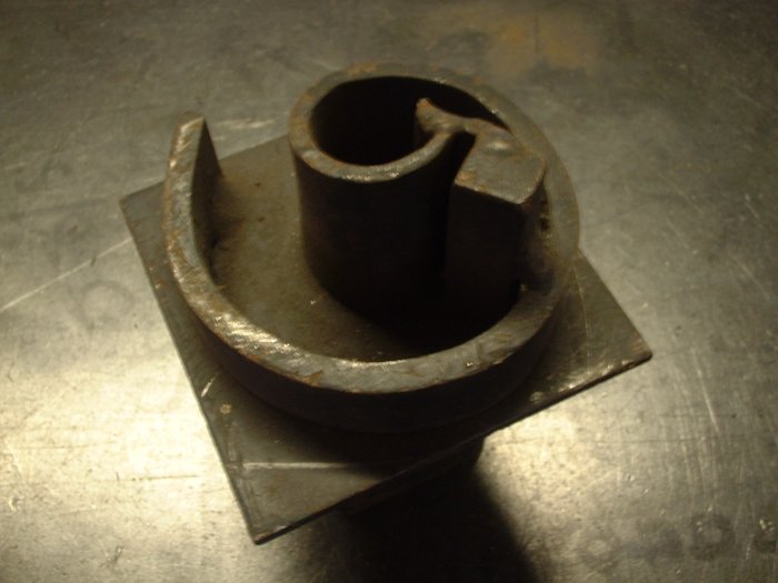

Mine is an ali casting thats been split into 3 bits & mounted on two hinges. The central bit is fixed mounted, you start the scroll & lift up the other two sections after you have scrolled past the first bit. Using a split scroller keeps the scroll you make flat.

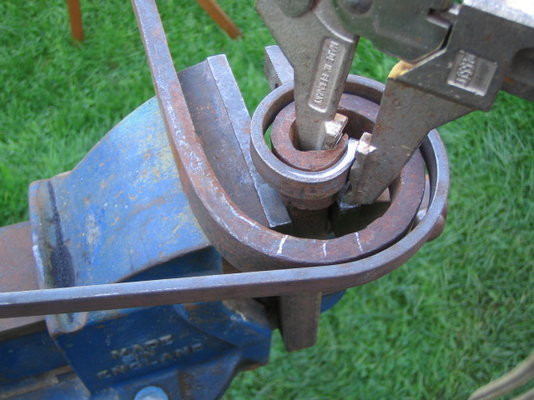

If you only want to bend 3mm flat a lightweight former like this will be ok,
Ive made hundreds of scrolls with it, its mounted on a square box section so if you're tight for room you can turn the former in the vice.
