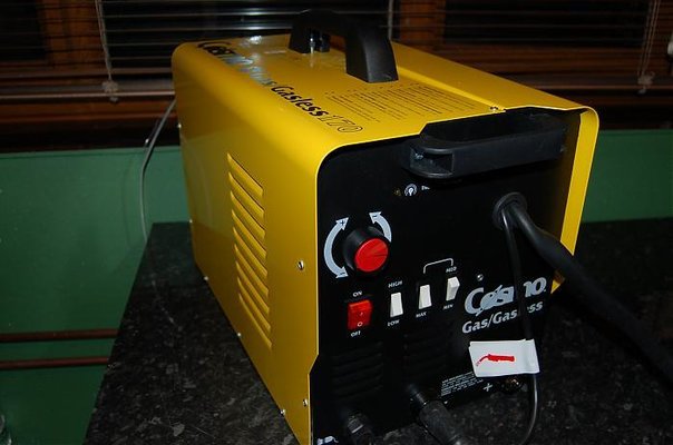

I bought a Cosmo 170 a while back (we are talking years not months) and it hasn't seen much use - doing the odd plug weld to fix a bracket on my track car and a small patch in the floor to fix a water leak - none of them pretty and thats about the limit of my abilities and apparently this shonky welder!!
However I've ended up with a bigger task (a mini that needs new sills) and to be frank I'm struggling to get to grips with this welder - it might not help that I've lost the original instruction booklet but from memory when I read it from cover to cover it didn't seem like much help so is probably filed somewhere never to be seen again - I'll try to contact COSMO andsee if I can get another copy as advised elswhere on another thread
Anyway enough dribble - I have a welder that has
- rubbish wire feed (and it certainly is) but there is a fix detailed on here) so first job tommorrow is to do that - slips like crazy and the rollers are way out of line
- doesn't like gassless wire bunches it up after the feeder
- makes bigger holes in things when trying to join metal or has little or no penetration and the wire feed settings and power settings are a lottery to me it seems

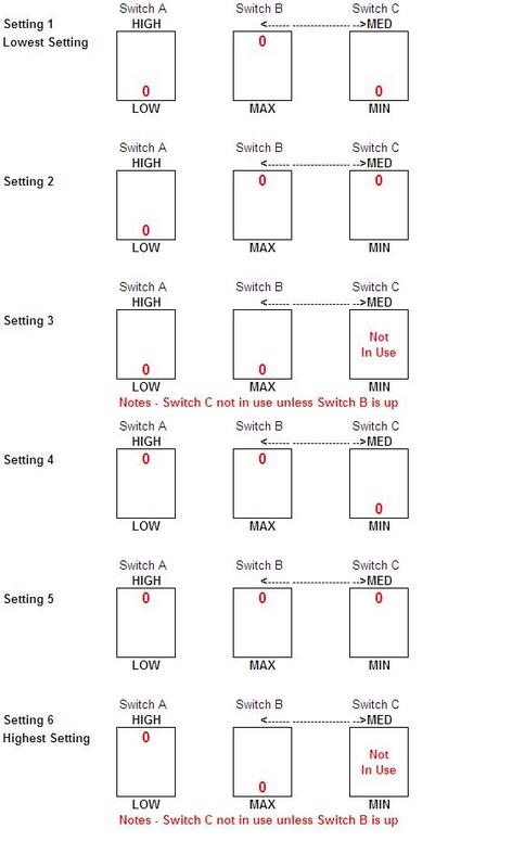

On the front of the welder there are a series of power switches
I may be being a bit thick here but can anyone help with the sequence of switch positions from lowest to highest power output?
I know that on this welder the power settings also make crude changes to the wire feed speed but the wire feed adjuster pot can be trimmed accordingly

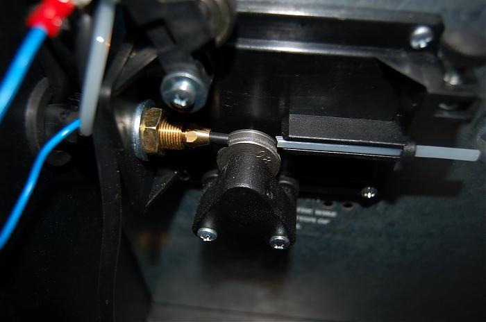

I spotted this picture
And thought oooh now thats different to mine - the liner comes almost to the wire feeder on this picture and I can't even see the liner on mine - this may acount for the poor performance of gassless wire
