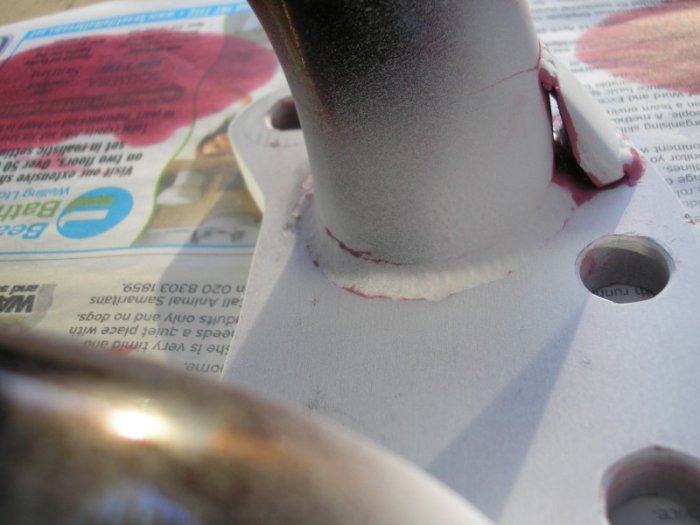

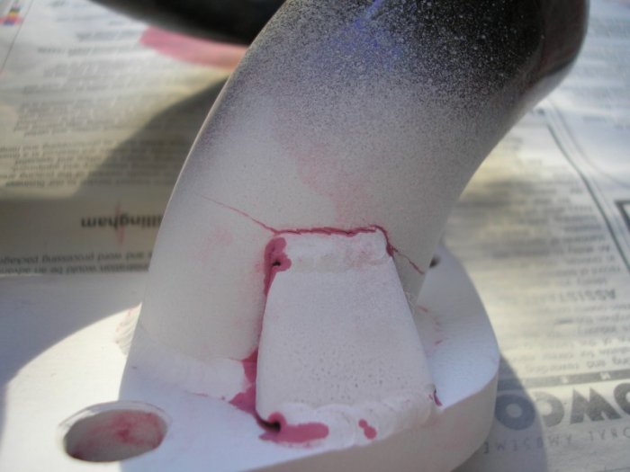

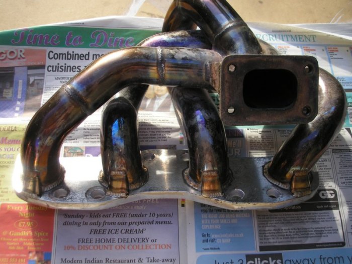

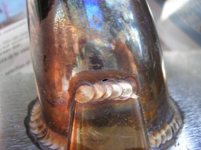

Stainless turbo manifold off a Nissan 200sx, less than a years use and only the stock turbo fitted
This is why it is was brought to me
Pretty obvious from this pic that the another (pulsed autogenous) pass was made after welding the manifold- presumably to get 'the look'
. Looks to have been 'well cooked' too. You can just make out the crack running away from the hole. I found several more

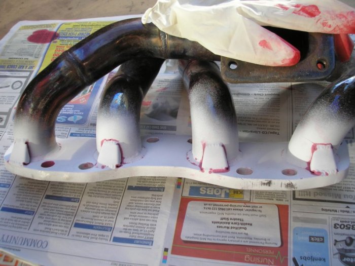

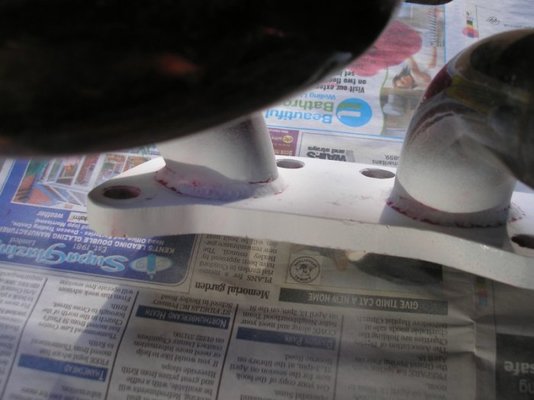

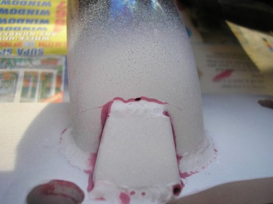

There was some discussion about the merits (or not) of gusseting this sort of thing on WW so i DPIed it to see how bad it really was and make it easier to photograph
The gussets were a pain with regards to DPI but this is what we have after 10mins contact time
