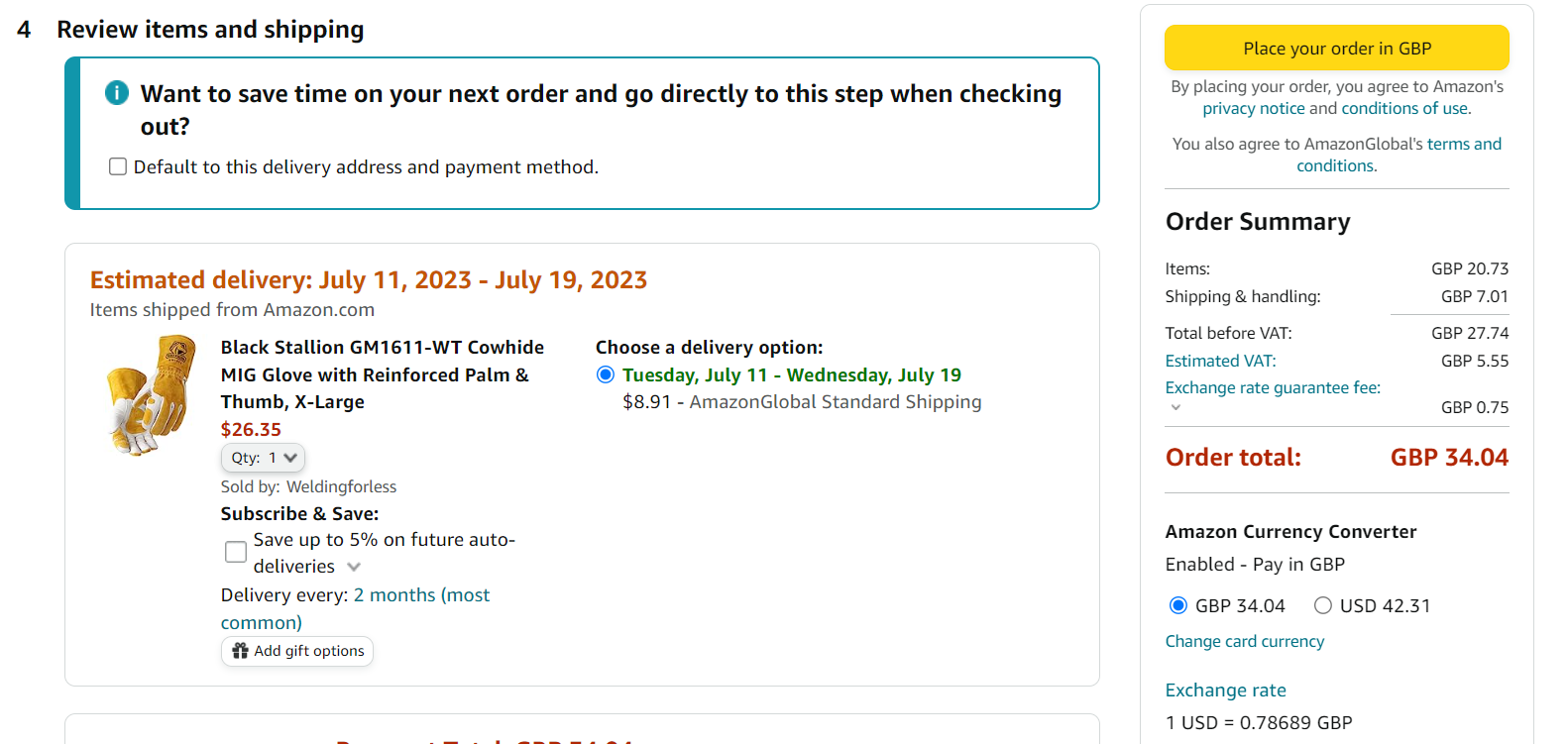

Hi, needing a pair of new gloves. Any recommendations? Mostly MIG, some stick also.
I quite like the Tegara 17 (short cuff "Drivers Glove" style) and Tegara 19 (Gauntlet style) paired with one of those backhand pads.Get something flexible and use a heat reflective backhand pad on your hand that's not holding the torch.
What are you using on my TIG glove I stick foil tapeGet something flexible and use a heat reflective backhand pad on your hand that's not holding the torch.
Use them for MIG and HH plasma torch TBH until it gets too hot, loads more feel/grip than MIG flip flopsI quite like the Tegara 17 (short cuff "Drivers Glove" style) and Tegara 19 (Gauntlet style) paired with one of those backhand pads.
They're pretty thick and heat resistant, but are a properly articulated glove shape to give decent dexterity still.
