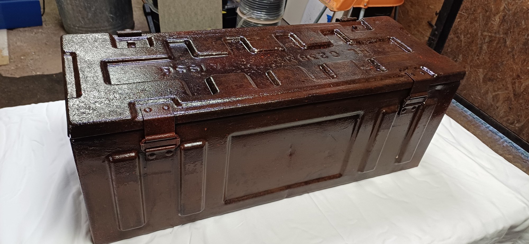

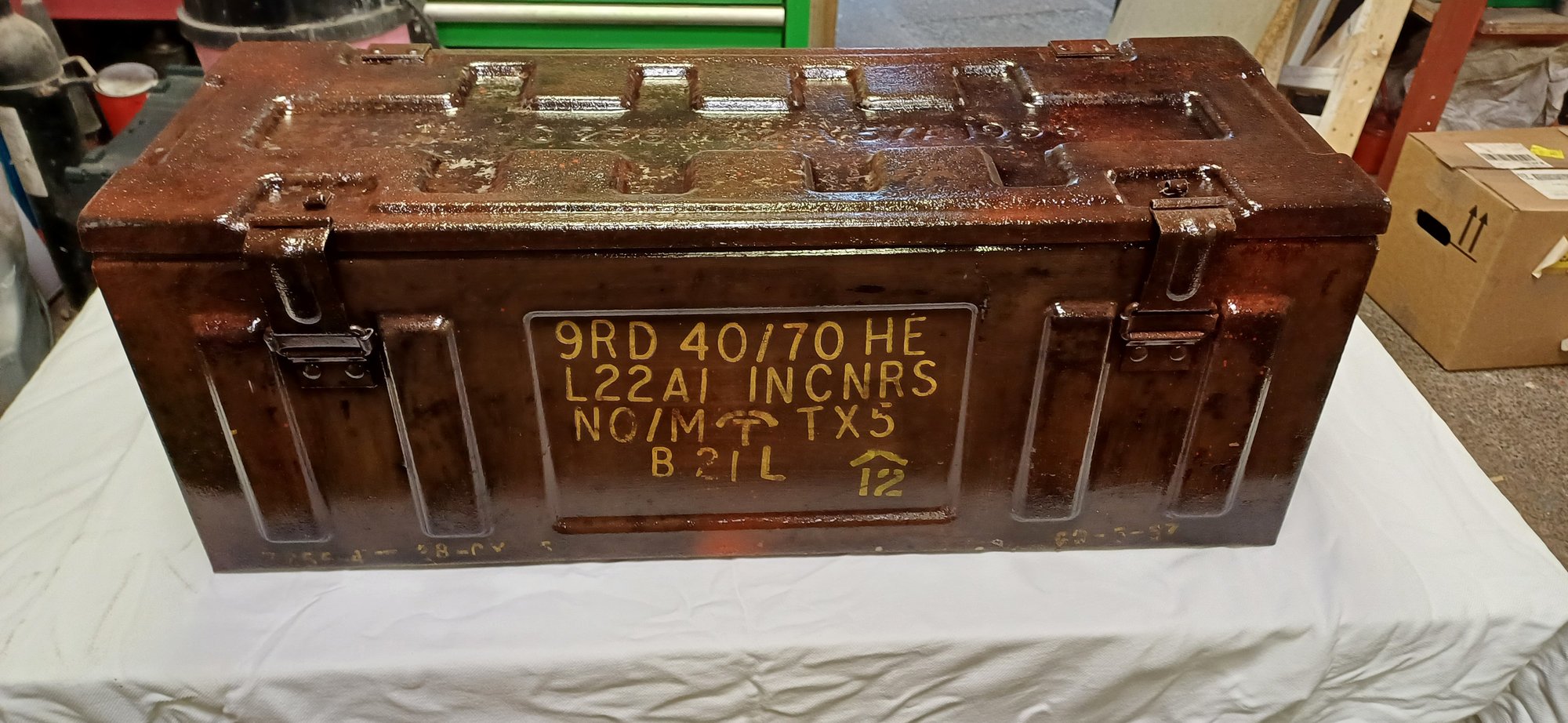

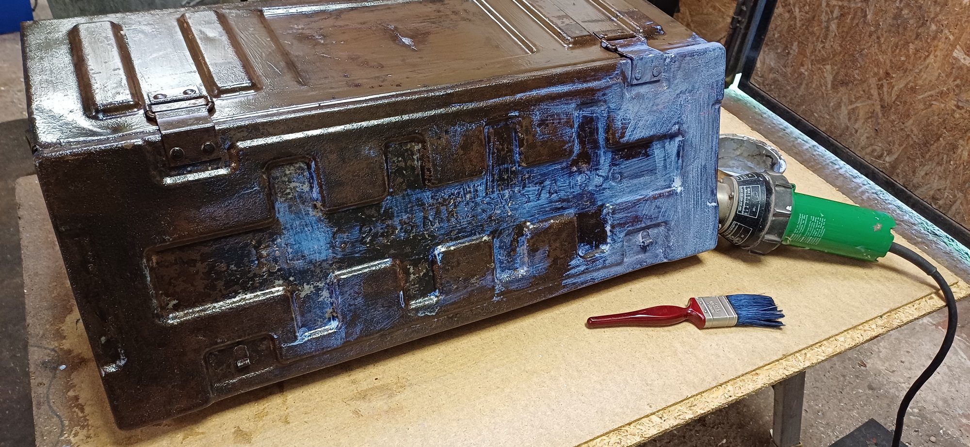

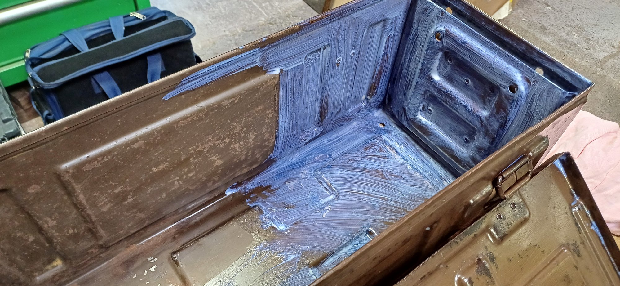

This 1956 ammo box was left out for scrap, aftera good clean and brushing I pointed the heat gun inside it till it was warmed up, then i brushed it inside and out with vactan/ kurust which dried fast with the heat, the idea was to stabilize the rust and the two coats of clear coat soit keeps the patina look, it will end up on a mates vehicle as a storage box.
