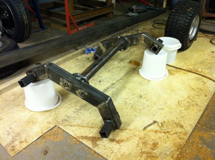

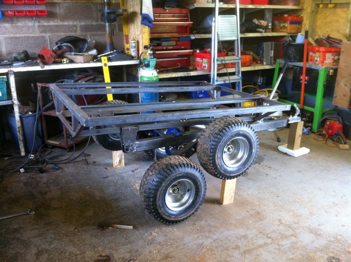

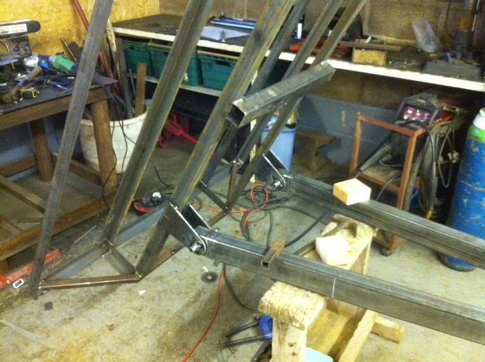

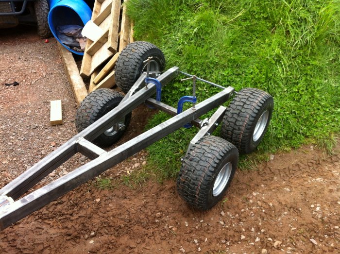

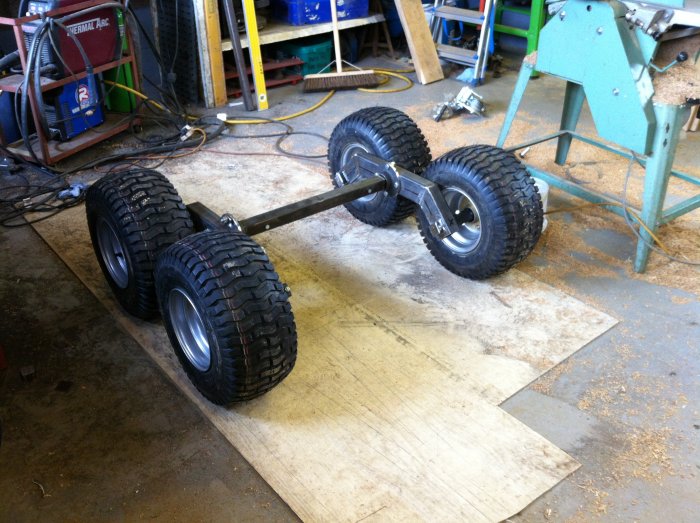

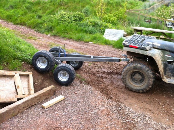

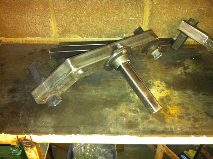

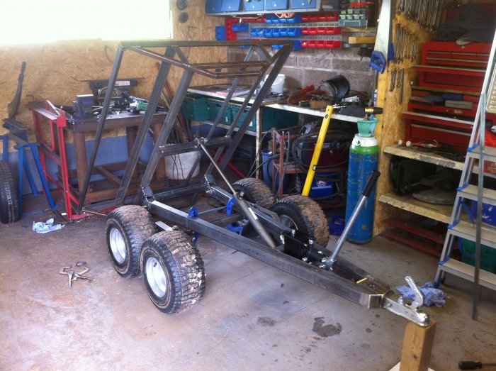

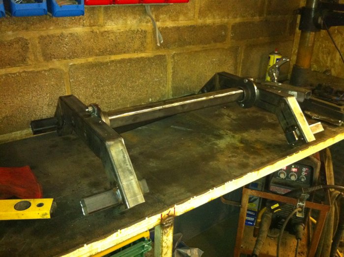

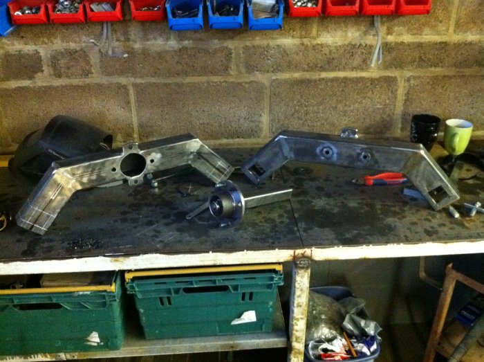

After a year or so of research, I've finally started my atv trailer build.
Tandem walking axles, possibly multi-body, tipping trailer. Five feet long and four feet wide, and I've opted for a smaller tyre/wheel in four 18x8.50x8 with lawn type tread to hopefully save my lawn.
I'll try and keep this up to date but apologies if I slip.......
Oh and it's going behind a Sportsman 500
So far just the tandem bars
Cheers
JF
