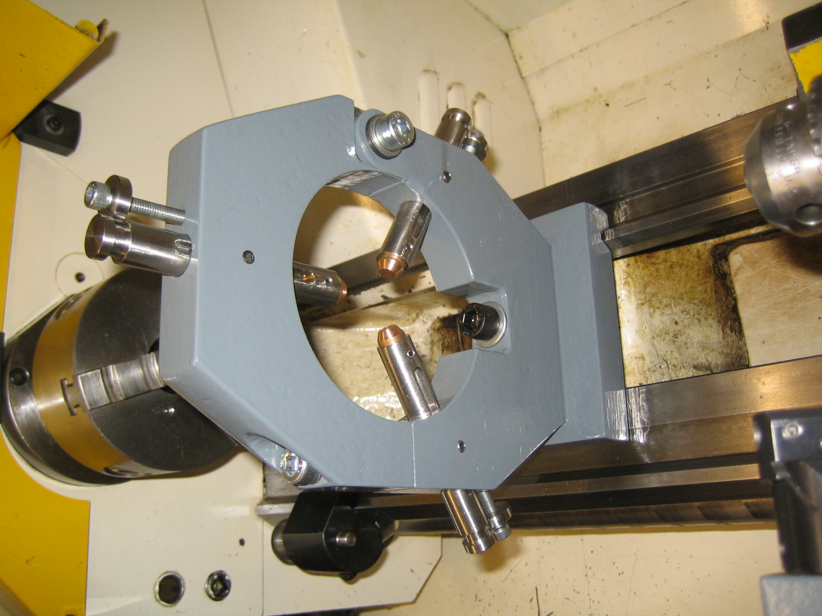

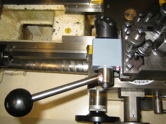

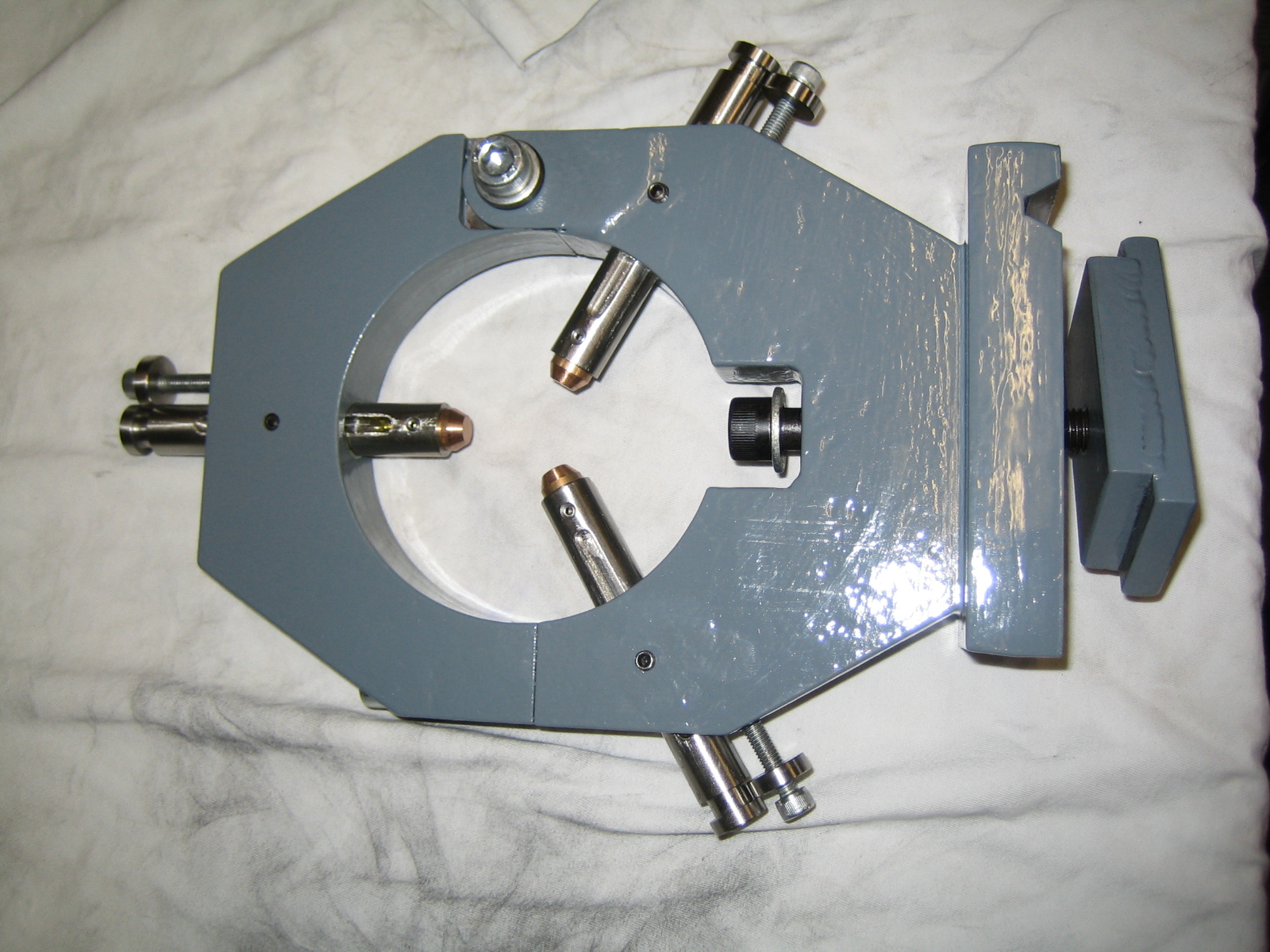

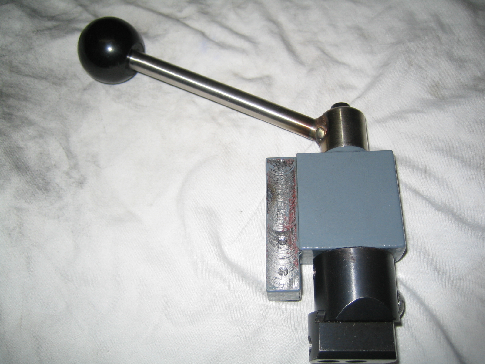

Much too tight to pay Boxford prices, so I had my own fixed steady. the tips are interchangeable, those are PB but I have also made brass and plastic if I need something softer

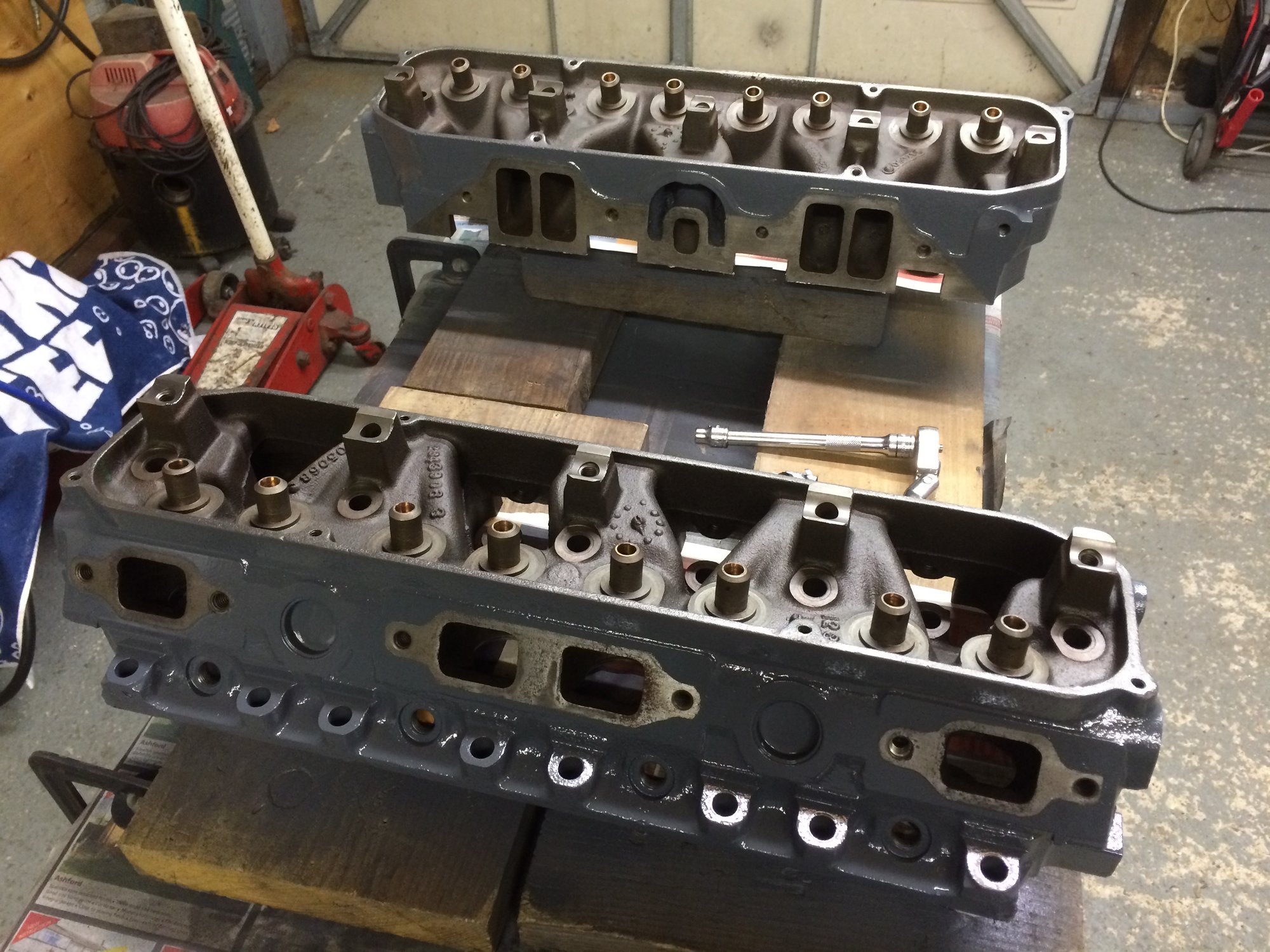

Nearly run out of Dark Admiralty Grey, soon be Aldi Silver
It's Lycoming Grey aircraft enamel paint on a pair of Chrysler big block cylinder heads, the lightest thing on the Jensen they sit in next to the alloy thermostat housing as the rest is cast iron. Oh, there's the cast allloy rocker covers too but they are heavier than twenty pints of Heavy!
