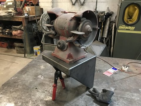

At the moment my two bench grinders and drill press sit on a 2.5ft x 4.5ft steel topped work bench which is a horrible waste of a bench and possibly an even bigger waste of space.
In order to partially remedy this situation I've decided to make up a pair of wall mounting brackets for the bench grinders and will be doing some type of tripod stand for the drill.
I've seen similar mounts before but why buy something in when you could spend the time making it yourself?
I would have liked to cut the net out in on piece but as my folder doesn't have removable fingers so I split the two side gussets and made it in three pieces.
Fortunately everything slotted together nicely once it was all folded up.
Here's one down. The joints were nice and tight so I just ran the TIG torch down them and fused the pieces together. Now onto the second mount and the drill press stand.

add a small trough of water at the front to cool the tools when sharpening
