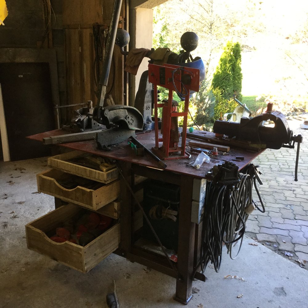

I have a big old un.....French made cast iron effort....
easy to cut 1.5mm but only 4-5 inches in one hit....
but remember they tend to pull off the line.....when I use mine on plate I put it a little out of line so then it pulls / cuts straight......
