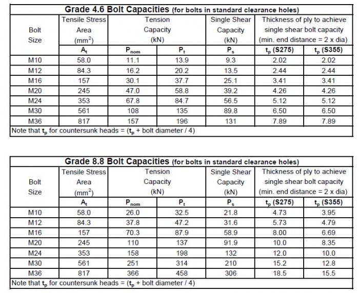

thanks,very detailed-but how do i interpret that into a static load in kg?
Thanks paul,that confirms my guesses from the past weren't far wrongConvert kn to kg force by multiplying the force in kn by 101.97
so from the first line of the top chart for example, M10 bolt in shear has a capacity of 9.3kn x 101.97 = 948.3 kg
there's a bit more to it than that but I guess this is near enough for your purpose.
