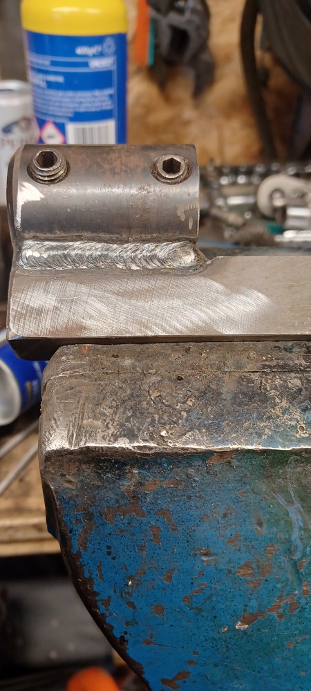

today i made up a couple of boring bar holders , lopped the ends off the holders that had the qd part with coolant supply and used the arc gen to weld some flat bar ,had to carefully align the pinch screws and sleeve to plate
rods were kobelco 7016 imho one of the best ever electrodes
