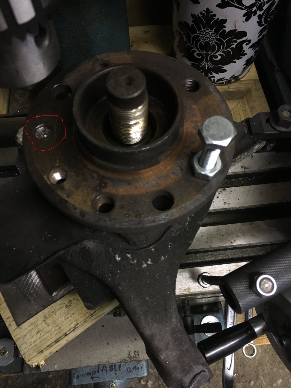

having to sort out a cv gaiter and drop link arm,
i thought it best to sort the broken wheel bolt too.
took the hub unit off the car to make things easier..
i made a little spacer out of ali, to fit snug in the hole above the broken bolt.
used a transfer punch to centre mark the bolt..
ive tried a 3mm drill bit but for general purpose im wasting my time.
i need a drill bit to get me through this hard stuff.
whats best to buy.....
cheers all
