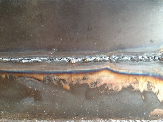

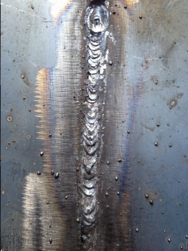

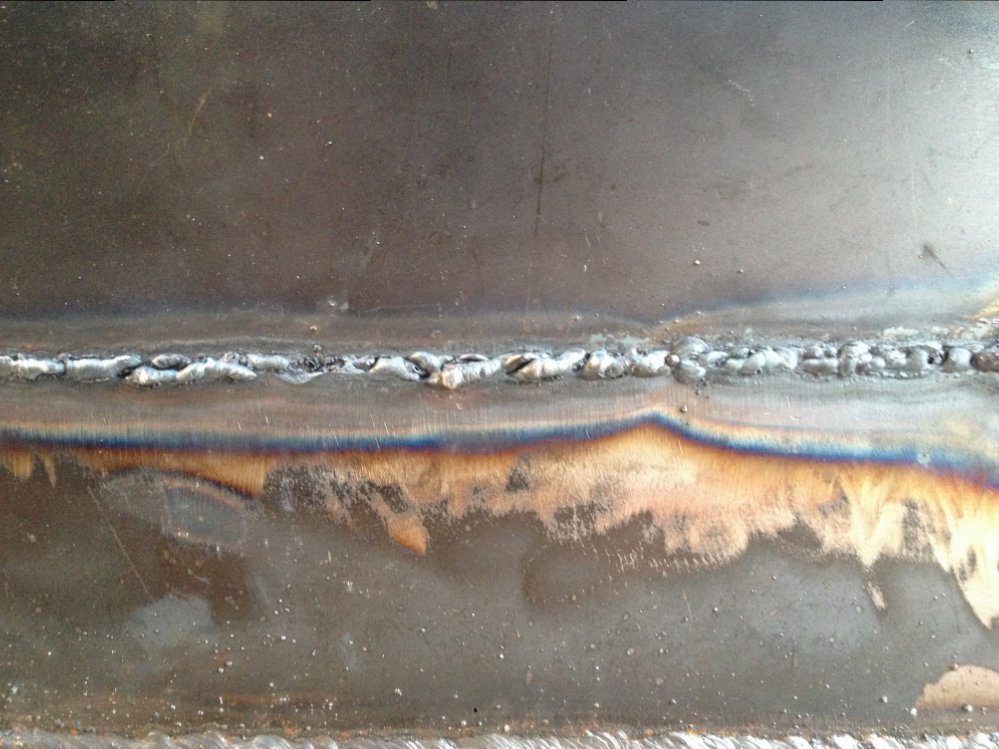

Can't get the hang of butt welds , tried 5mm with prep , root pass with 2.5mm at 80 amps .weld falls through gap , so I tried weaving side to side and that just made it build up on the sides. Tried going slower and I started to burn through , tried it without prep and then can't get penetration . Really struggling with these anyone got any advice ?
to fill a 5mm open route with a rod only half the thickness ( if I understand what your describing correctly) but also pointless as you can penetrate sufficiently without using so big a gap. Fast freeze type rods also help like 6010 etc. when doing open routes
