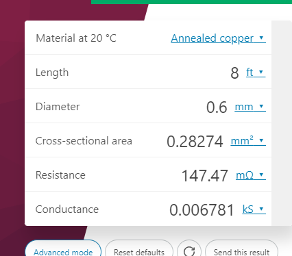

I'll guess the conductor is about 0.6 mm diameter....
Resistance of about 8 feet is 147 mOhm (0.147 Ohm)
Power = I^2 R = 0.64 ^2 * 0.147 = 60 mW of power lost to heating in the cable
Voltage drop over the additional wire = I * R = 0.64 x 0.147 = 94 mV
Power loss and voltage drop are therefore minimal.
The above calculations are a simplification of the actual circuit. They assume the current remains at the theoretical 0.64 A, which it won't. However, they are okay for indicating the maximum power loss and voltage drop.
