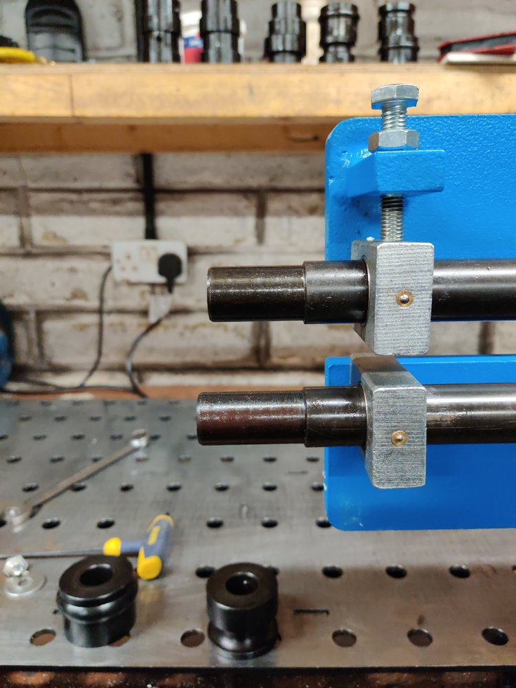

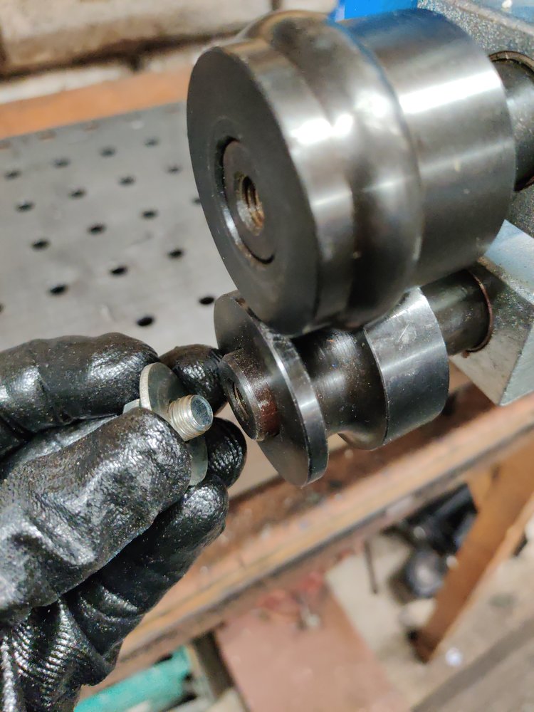

Out of curiosity, what did you pay for this? I looked up their site, but no prices appeared. I did find another make, looked identical, at 140 euro.Just unboxed this 18" bead roller. The reduced diameter on the end of one of the bars is longer so the die can't be bolted tight. No idea if this is another Vevor quality issue or is normal.

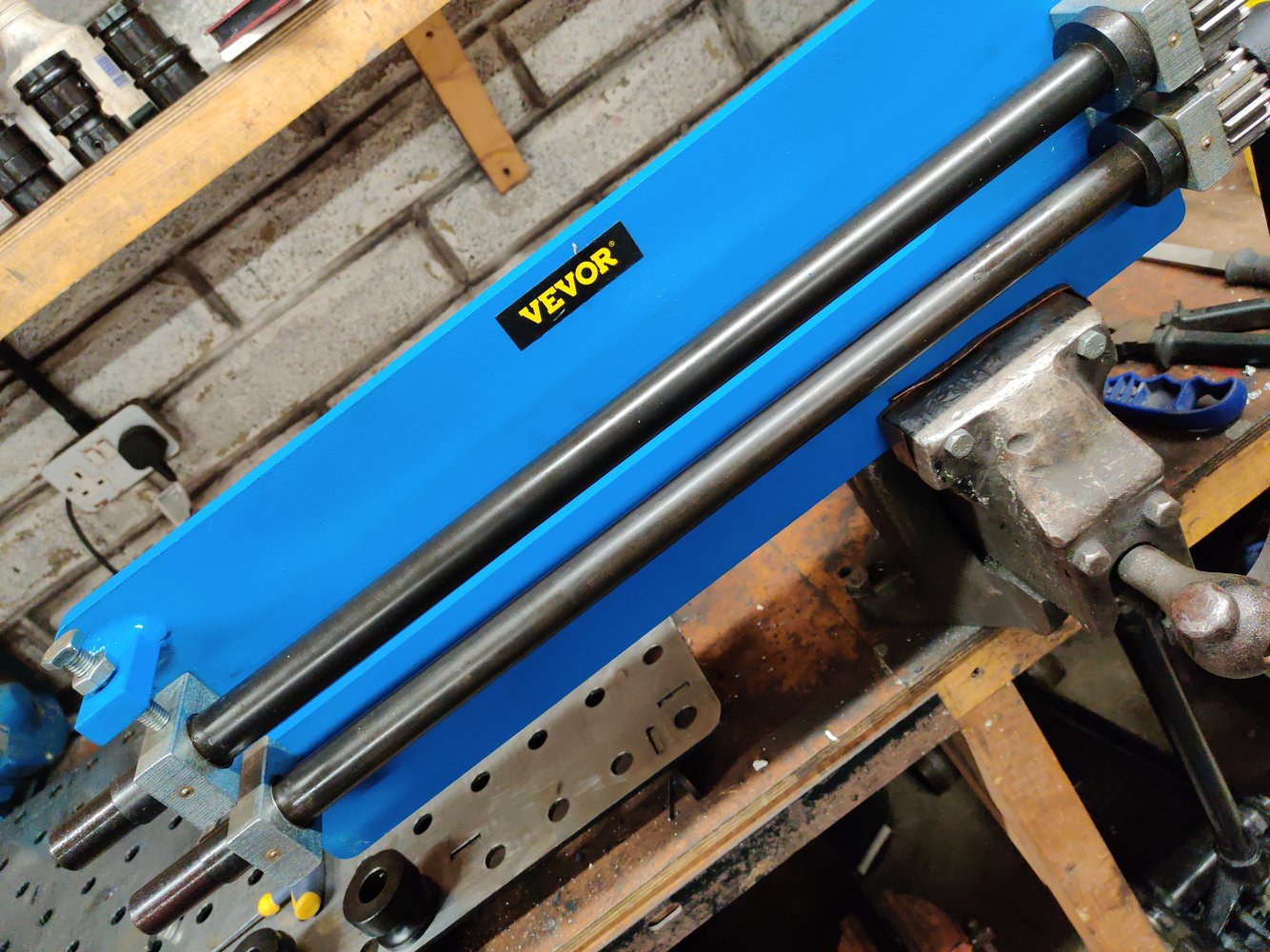

I paid £130 delivered just a week ago. I've done my first project now, it rolled a nice bead.Out of curiosity, what did you pay for this? I looked up their site, but no prices appeared. I did find another make, looked identical, at 140 euro.
Thanks.I paid £130 delivered just a week ago. I've done my first project now, it rolled a nice bead.

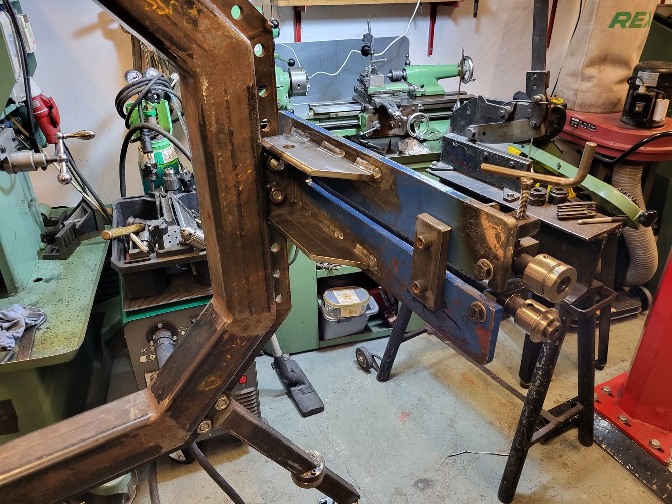

They're certainly excellent value for money, But I found that a bit more rigidity was needed for thicker steel work. I also found that doing anything intricate really needed a 'handle turner' so that I could concentrate on steering the work. I wore out my welcome with Sue on that one, so adapted a stairlift motor to drive the rollers via PWM speed controller.I paid £130 delivered just a week ago. I've done my first project now, it rolled a nice bead.
