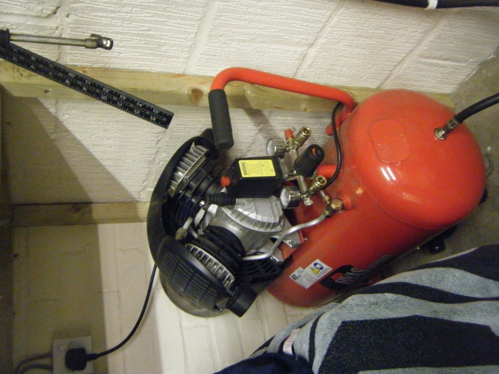

I have a little 50l, twin piston direct drive compressor, its in my garage which is in a block for the people in our close, my garage backs onto someone elses garden, I have only been here for 7 months and don't want to annoy my neighbours, its also to loud I usually get out the garage when its on, I downloaded a decibel app on my phone and measured it at 86db.
compressor
airline etc

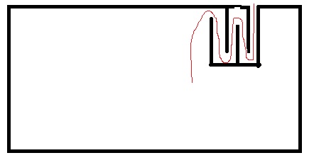

the compressor sits under my work bench, I plan to build a wooden frame around the compressor then board it off with mdf or ply wood and have a door at the front so I can get the compressor and turn it on and off and drain water etc. all the joins would be sealed up with silicone sealant and a small rubber seal around the inside of the door so I closes tight with no gaps?

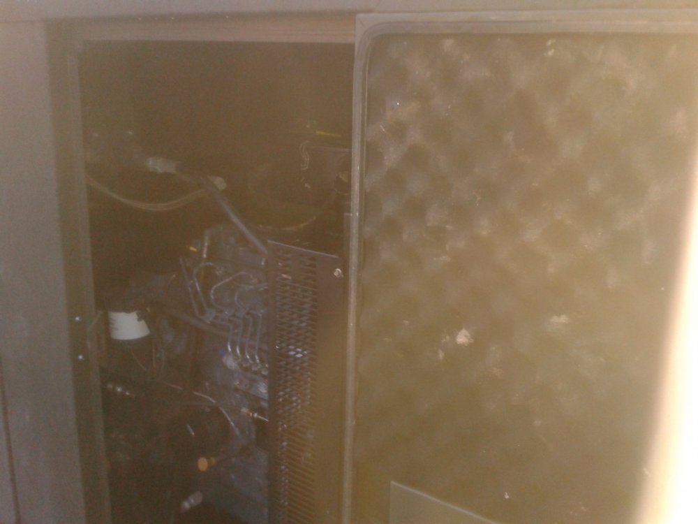

I want to line the inside with some sort of sound proofing but unsure whats best? I have never delt with anything like this before so just searched sound proofing on ebay and it brings up products like this
http://www.ebay.co.uk/itm/Acoustic-..._Acoustic_Treatments&var=&hash=item51ab415a0a
can be sprayed with adhesive and stick to all sides, roof and door, does any one have any experience with this product or anything like it?

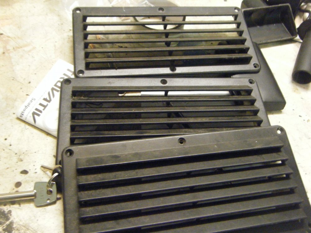

my biggest thing is going to be ventilation and cooling. I have a few of these in my 'random bits box'
I could place one low down at the back of the box which would such in cool air and one high up on the door which would let warm air vent out from. there is a large van on the back of the compressor which sucks air in and blows in over the pump, problem being I don't want this box to take up to much space and at the moment I run the compressor hard against the wall, this fan is then around 1 inch off the wall, is this a problem? I was thinking of getting a bathroom extractor fan to put into the side of the box with the flexible ducting to direct cool at the back of this fan?

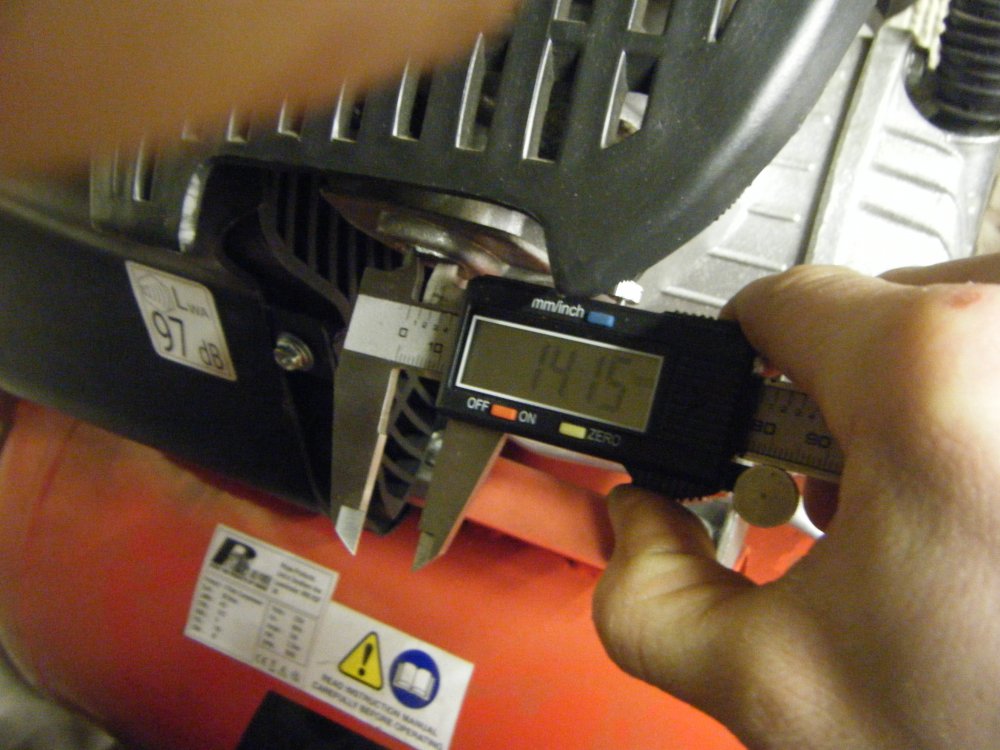

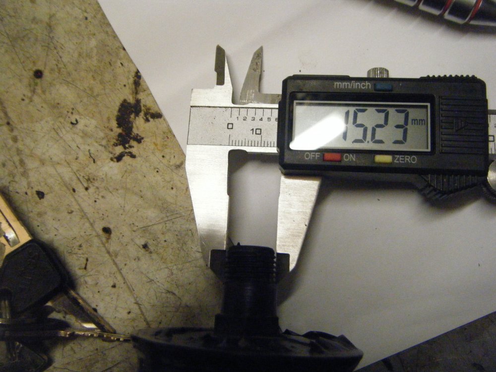

I want to remove the small air filter from the heads, and with the fittings and some hose running outside the box and mounted on the wall so I don't draw in warm air inside the box which will cause more water inside the tank? I need to find out what size the fittings need to be in the head, I know after using a gauge from my tap and die set that the pitch is 1.50, and my calipers show an external diameter of 15mm, it this a normal size?
one last thing for the time being in the hight of the box, the compressor stands 60 cm tall, my work bench that its under stands 95cm tall. I could build the box tight to the top of the compressor and have a little storage area on top or I could build the box right up to the bottom of my work bench is the top, giving me around 35cm of area for hot area to rise to and vent out, any input on that's best? Im thinking more of the second option
