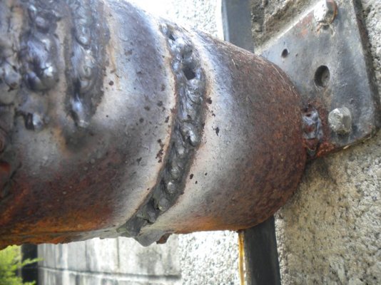

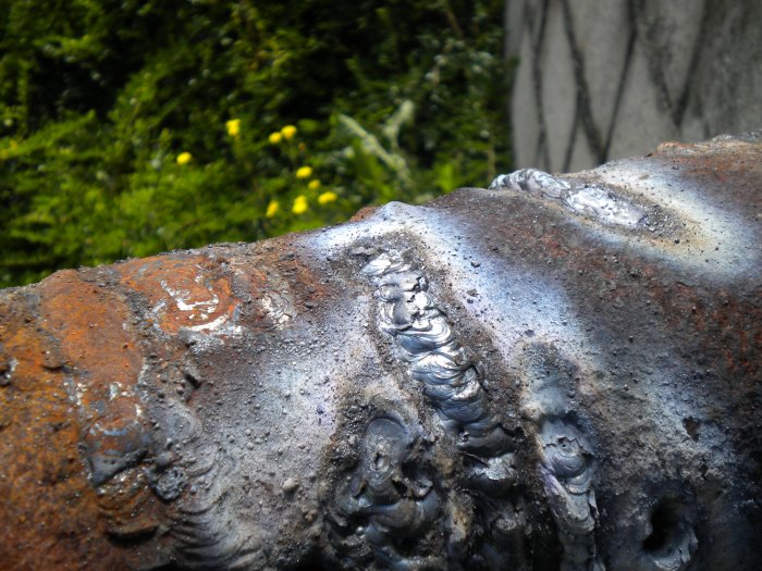

im leanrning to weld in my own time, I did the 1 night a week course a few years ago in FAS and I suppose with my own practice Im at intermediate level now
im quite good at flat welding welding two pieces of steel together
not too bad at uphill either
things im not so good at- when I hit a soft patch in the steel being able to keep a consistently good weld, im ****e in fact when this happens, I need some instructoin on what Im doing wrong hence Im wondering about a course?
Im trying to well 4mm walled 6” pipe in a single pass I am drawing lines using 3.2mm electrode 90-100amps using a Kuhtreiber inverter with 6013 3.2mm electrode, electrode connected to negative)
Wedling this pipe uphill and hiting a soft patch is a bitch, I can see the weld puddle digging into the steel and all of a sudden you have molten steel mixing with weld and slag, impossible to control what do the pros do to avoid this, I have tried speeding up and as soon as I hit a soft patch increase my travel speed with limited success, limited success being not blowing a hole in the pipe
see the pics below
Tried turning the rod at an angle, the idea being larger surface area of rod burning with the same current meaning less heat.
Tried turning down the amps, shortening the arc, it kinda works but then you hit good steel again and you say to yourself I need a bit more here…….. I must be doing something wrong…….
Be nice to be able to weld light stuff 2-3mm steel together without making holes in it too
both pics are from the same pipe, see what I mean about the molten steel flowing out of the pipe and flowing down into the weld puddle
