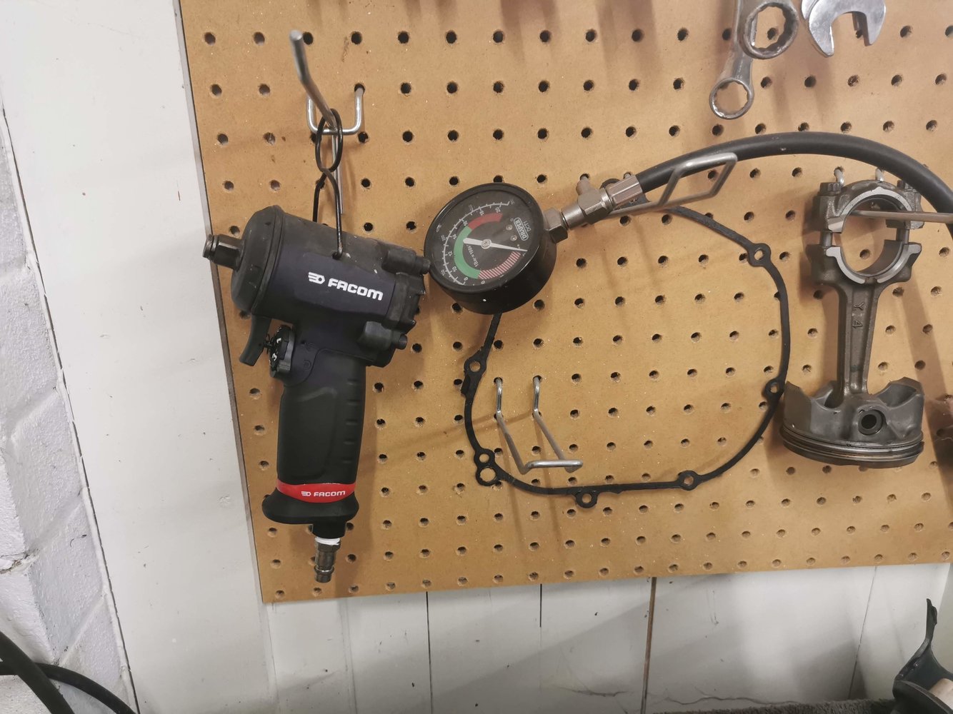

Air, cordless and mains all have pros and cons. It's about choosing the right fit for you and for the task.
For example, I really like the way air tools will stall out, especially die grinders, disc cutters and sanders - it safer when something "grabs" and the small form factor is useful. Air hammers and needle scalers too, very handy.
For bigger grinders electric is my preference - good runtime, cheaper to run.
Cordless is great for drills and impacts. Mostly more controllable, very powerful and portable. I still have my air impact but for a quick job cordless has it done before I've even unwound the airline.
