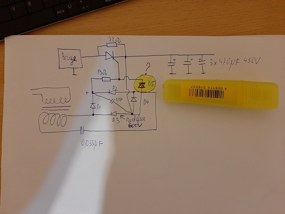

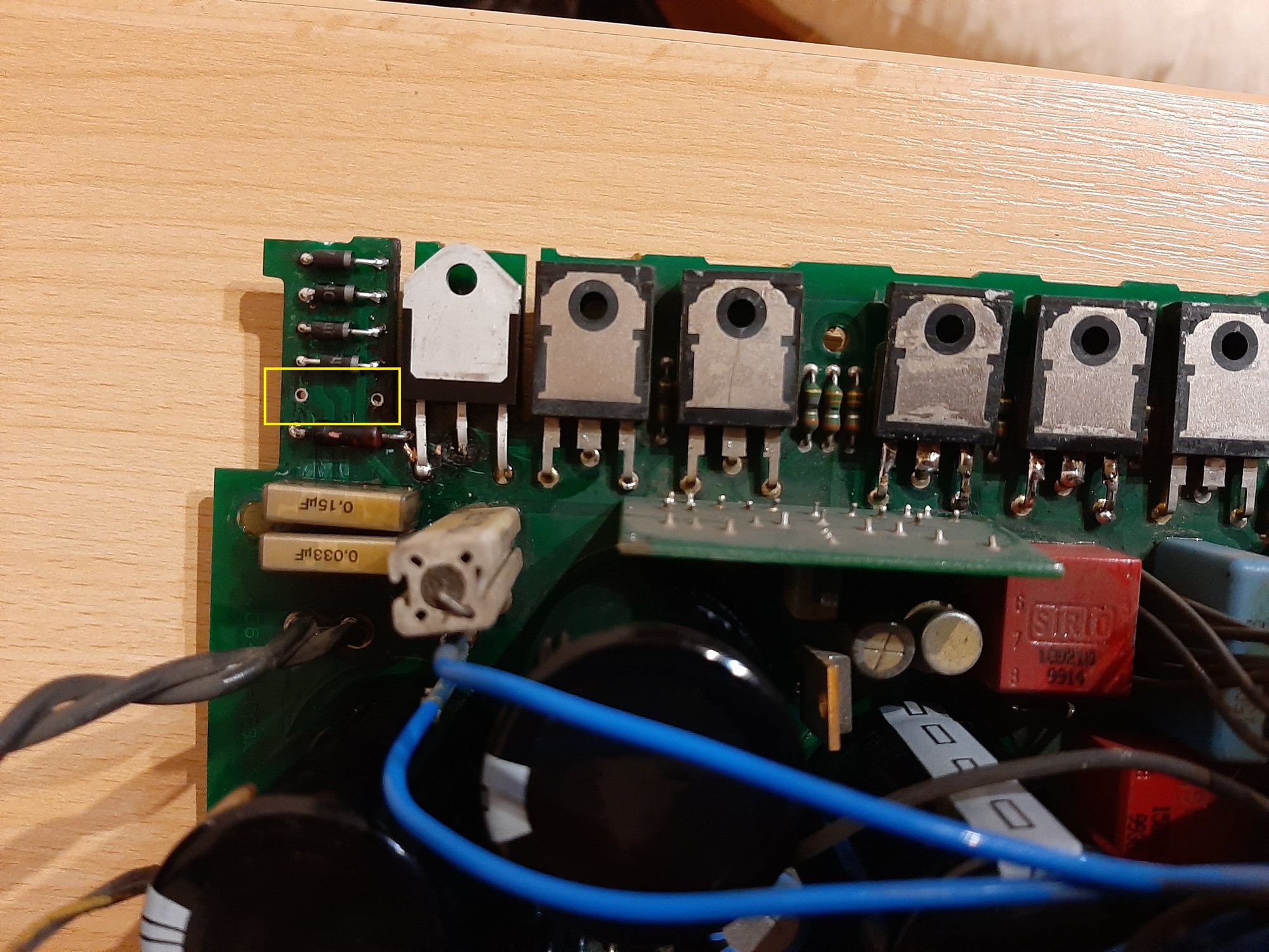

I have one ESAB Caddy lho 150 and the Thyristor was burned out together with other components. I changed everything, but I cannot figure out what is one part, can somebody help me ?
Looking on the PCB, I did a circuit around the thyristor and si looking like in the attachment. I am still not very confident what was there ? I am almost sure that was a diode, but what type of diode ? (was different from the 4x rectifier), what orientation exactly ?
I have also the drawing, but I am not sure what exactly was there.
Any suggestion will be very useful, can be a zener diode ?
Hi,
This circuit is very useful, the component is exactly what I assumed that it is.
Thank you a lot, it was very useful this confirmation, I was afraid to don't burn something else.
