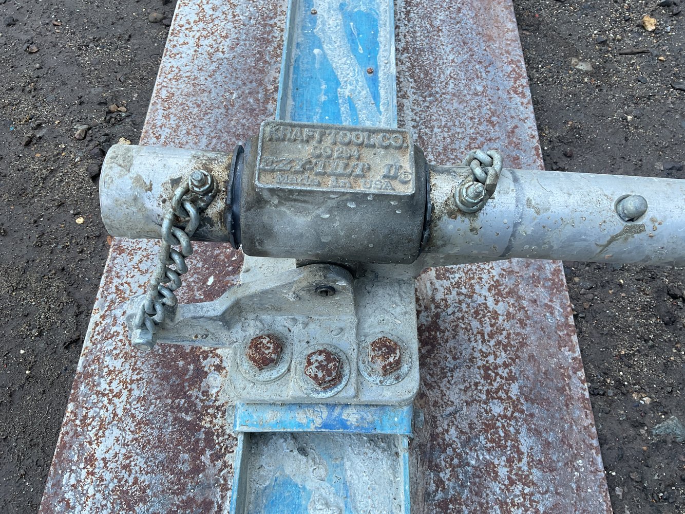

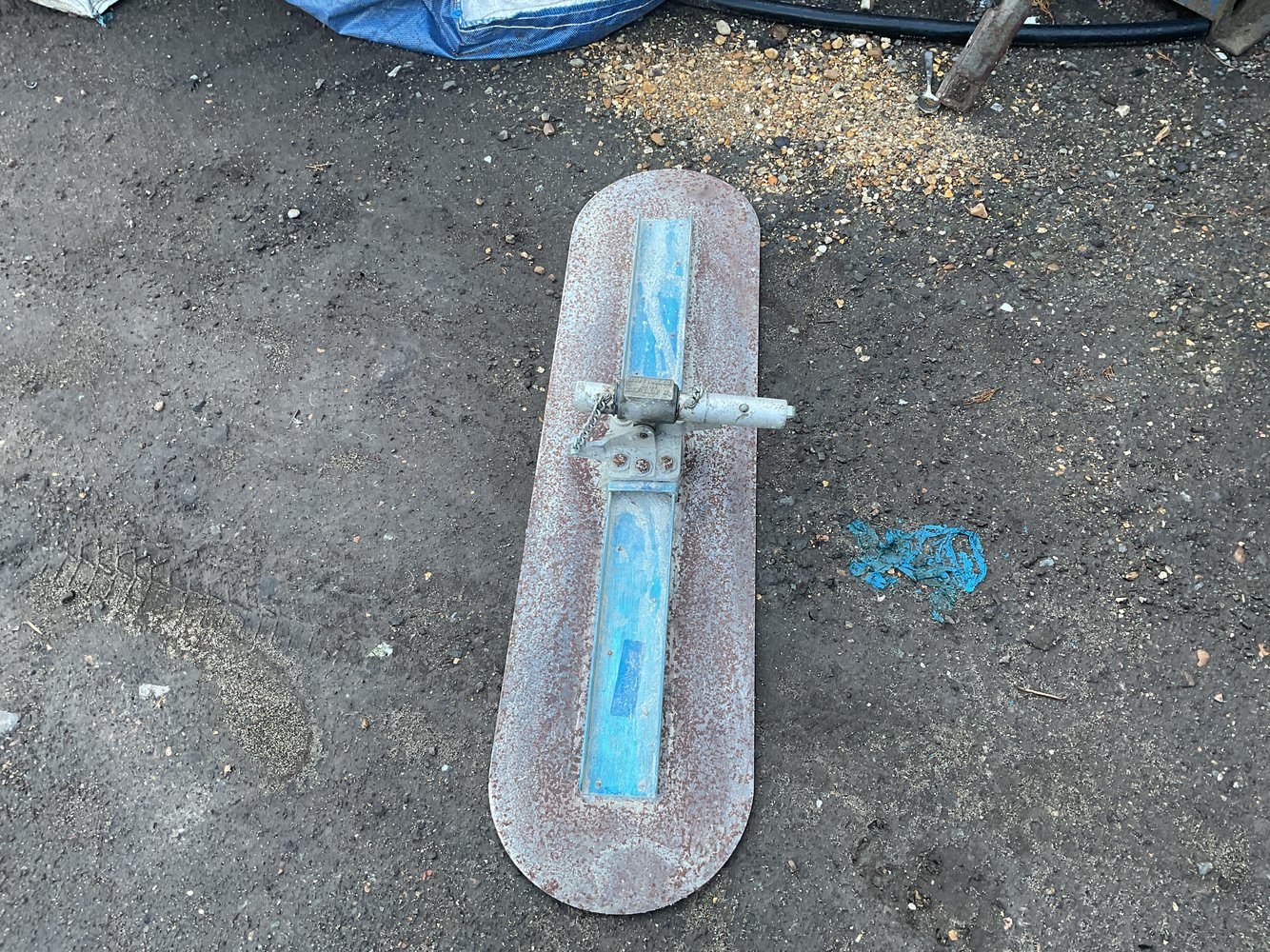

Fixed it for you.....Bull float is good. You can get a very nice finish. Or if you feel a little more adventurous go with a ride on power float

Get a company to supply the concrete, pour it and float it, it didn’t cost me much more to get it floated, I’d done all of the groundwork’s which is the expensive part of a slab, it’s floated almost as soon as it’s poured, within a couple of hours.I have decided to replace the flagged area where the Clarke garage is going with a proper concrete pad. It will be 7.5m x 4m so a larger pad than normal for me to do. biggest i hav edone is 5mx3m and that was shard but i didnt need it smooth. Well as smooth as i want it this time, I am thinking C35 will do it.
I am usure if to paint it yet but that will have to be done after a few moths once fully dry anyway.
Now what would be the best way to smooth it out ?
