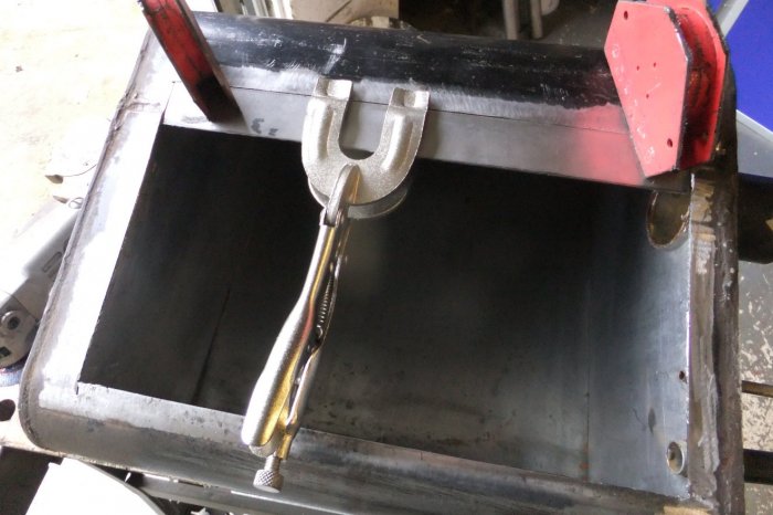

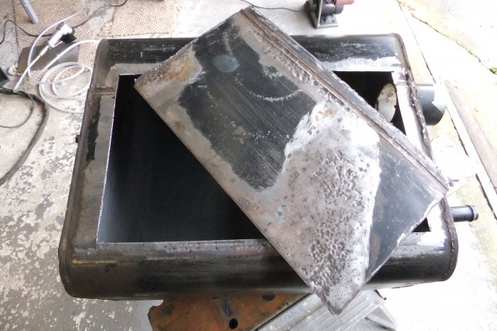

My TVR has twin tanks; when I took them out as part of an underhaul (it's like an overhaul, but underneath ) I found the left-hand one had a pin-prick hole in the top. As there was extensive pitting across the whole top of the tank I couldn't see any sense in just patching the one hole so I accidentally slipped with the plasma cutter and took most of the top of the tank away

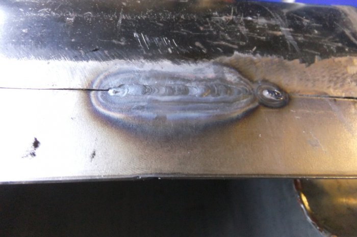

Of course the tank was created from a length of sheet rolled, overlapped and resistance welded, so I had to either work out a way to put a step in the repair piece, or else recreate the whole overlap. If there's a difficult option, that's me, so I cut a length of strip of the same thickness as the tank and tickled the plasma-cut edge of the tank with a grinder to get as snug a fit as I could...
A few tacks kept it in place...
and a tentative first length of weld was run.

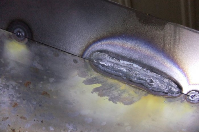

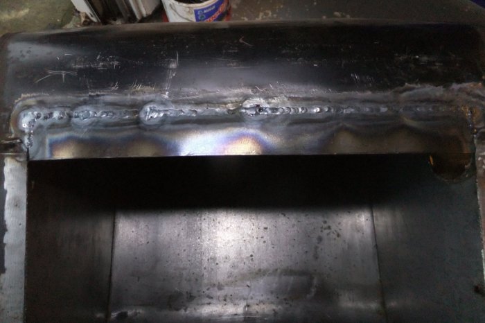

I checked with a mirror to see what the penetration was like:

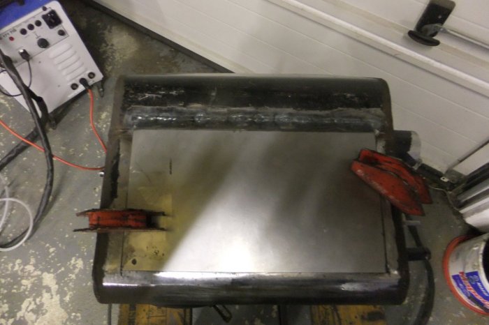

and I didn't think it looked too bad so I cracked on and welded the strip in. Of course the heat of welding it along just one edge pulled it all out of shape so I had to persude it back to where I wanted it :
I finished by welding the ends into the corners

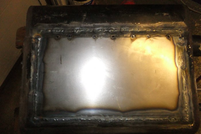

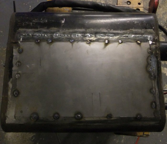

...and then cut another piece of sheet to fill the rest of the hole and match the original edge of the 'top' layer:

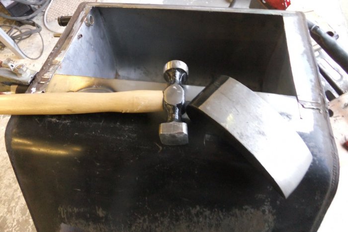

Some tacks and persuasion with the panel hammer later...

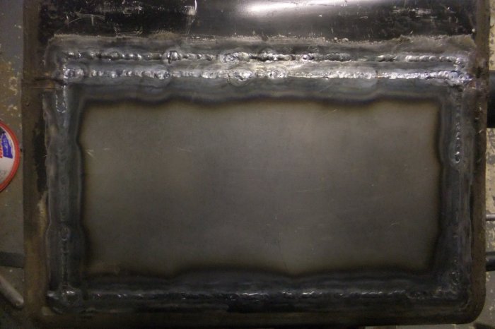

and it was time to get jiggy with the Tiggy !

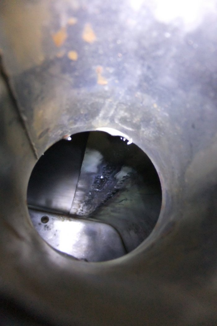

This left just the overlap to weld... but it was here that it dawned on me I'd never tried a TIG overlap on thin sheet Only one thing for it: blag it

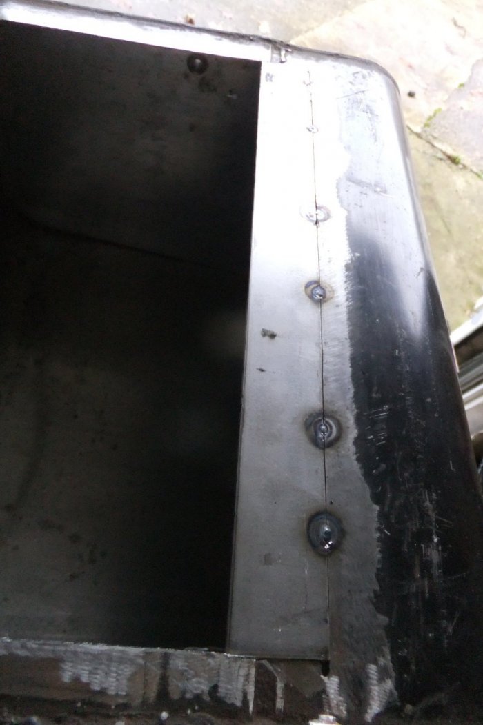

Looking at the inside of the overlap and adjacent butt, through the filler neck:
So, place your bets: where do you reckon the leaks will be?
