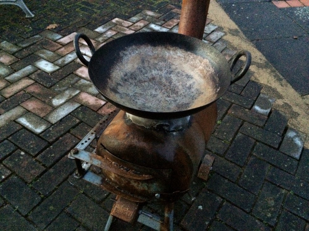

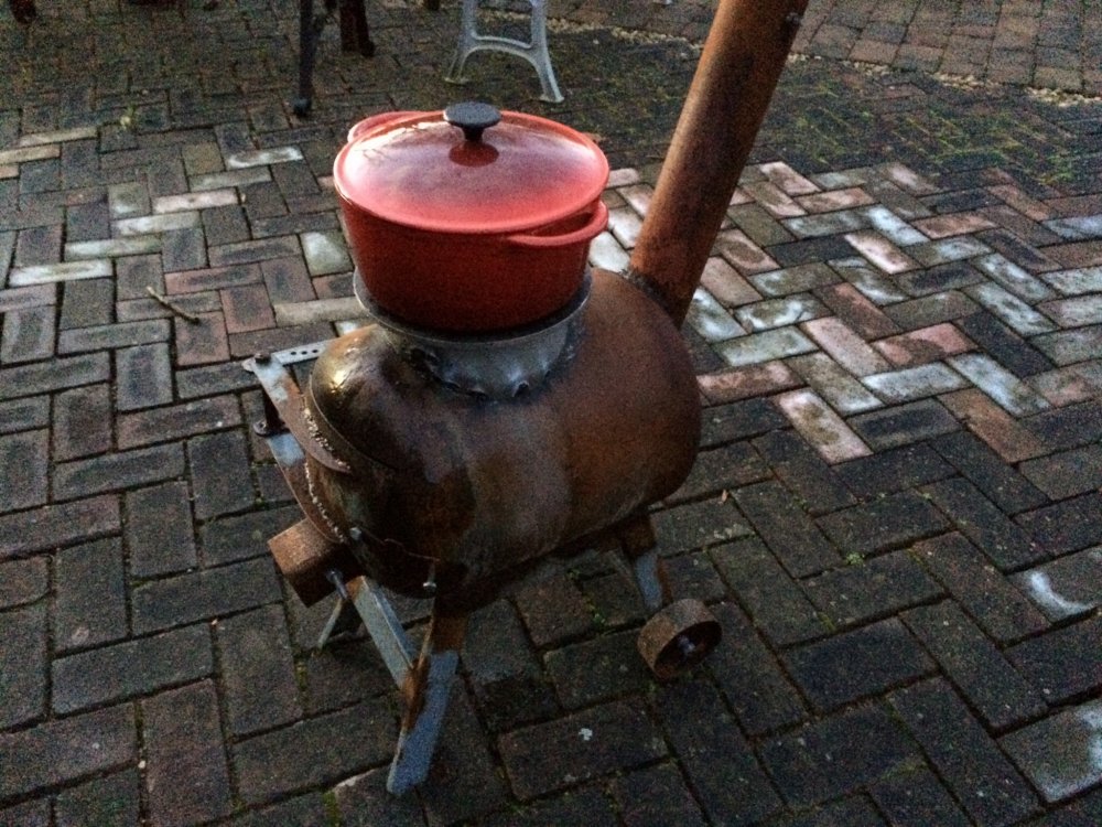

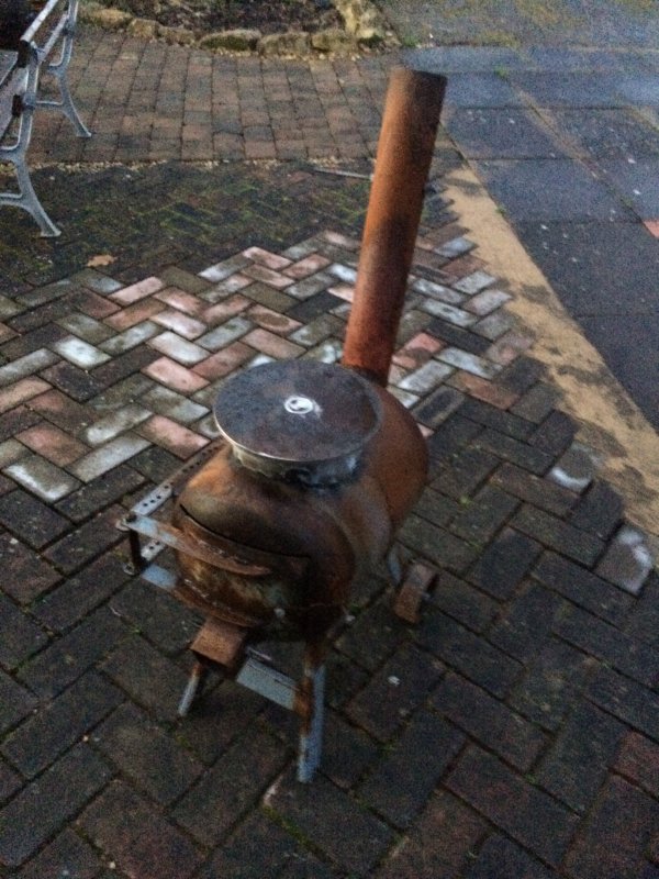

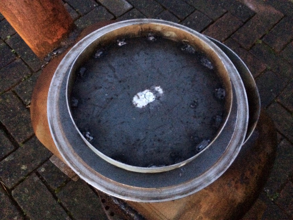

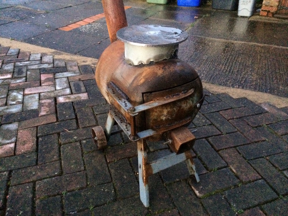

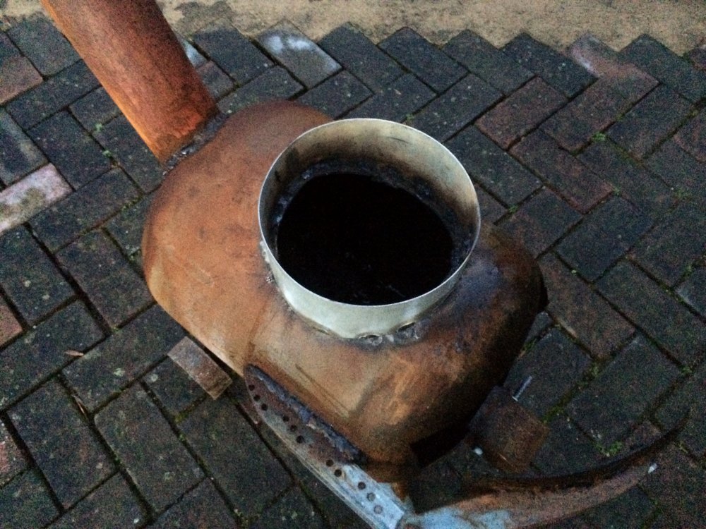

I'm not a welder by any stretch of the imagination but I can stick metal together with a basic arc welder that was given to me by a friend. I generally build "Things" as a hobby and have played with all sorts of materials. I have worked with metal but never welding.
I won't bore you with the construction details as you will probably know better than me. I took inspiration for this project from the various pictures I've seen on the internet and adapted for what I've needed to give me a portable wood burner that doubles up as a stove to hold a wok and a removable hot plate to use with a pan.
I love cooking and have a new found passion for cooking on wood. This complements about six other outdoor devices I have (not BBQ's)
The intake and exhaust have flaps to control air flow and are awaiting springs to finish off. The only money I have spent is on the welding rods (1.5 mm, which I think are under sized, open to any advice you may have), other than that all materials have been free and thanks to a friend who turned the hot plate to make it round.
All made by me, even the wheels !!
Feel free to ask any questions and enjoy the pictures,
