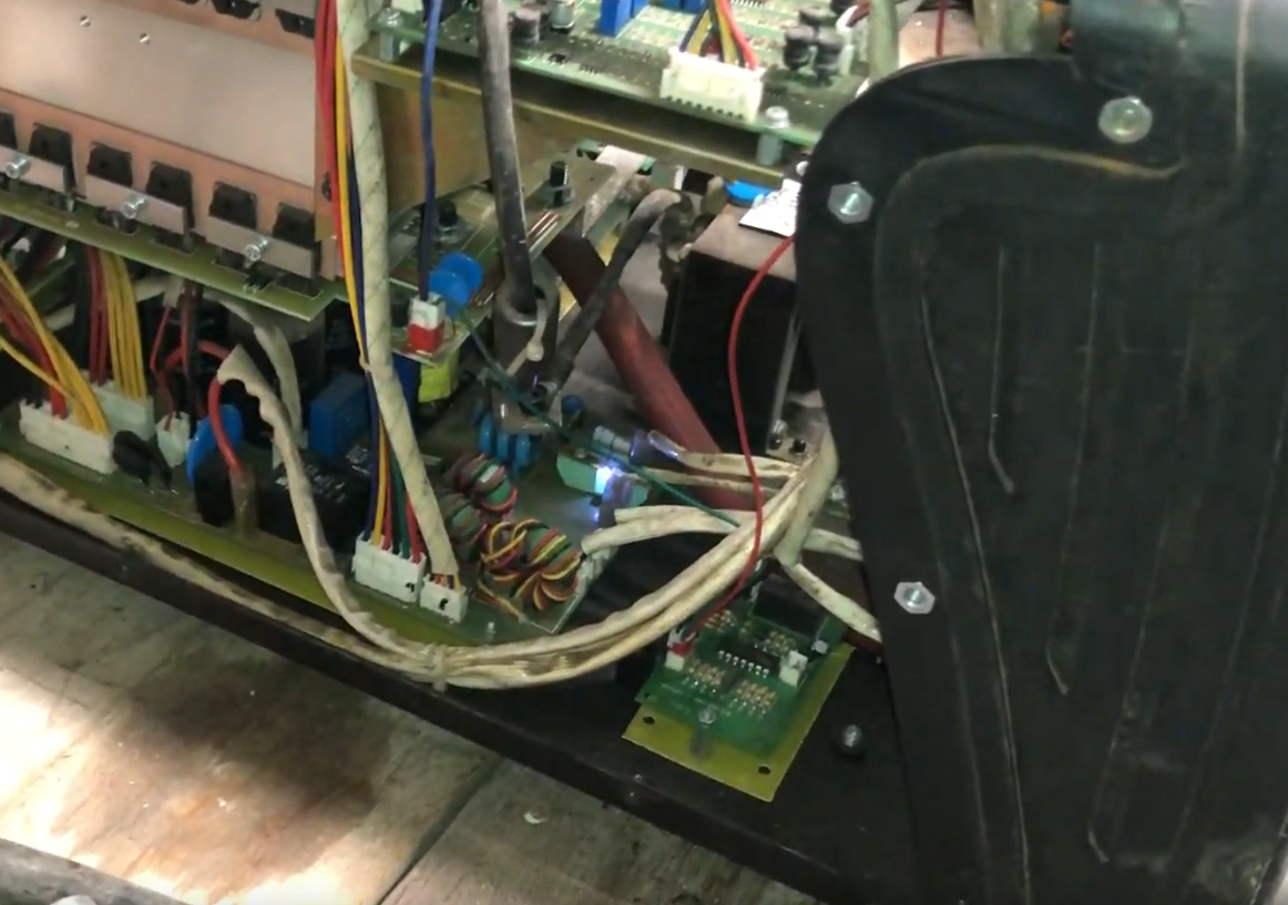

When I flicked the switch to "TIG", I immediately heard the internal spark gap kick in. This happened with or without the torch connected to the anode and the anode control socket. The button on the torch had no effect. The sparking continues for about 10s and then stops until I switch to MMA and back to TIG again.
You can see the sparking below.
My guess is that the welder thinks that the button is continuously pressed. I will check and see if the gas solenoid valve is activating at the same time too to confirm this.

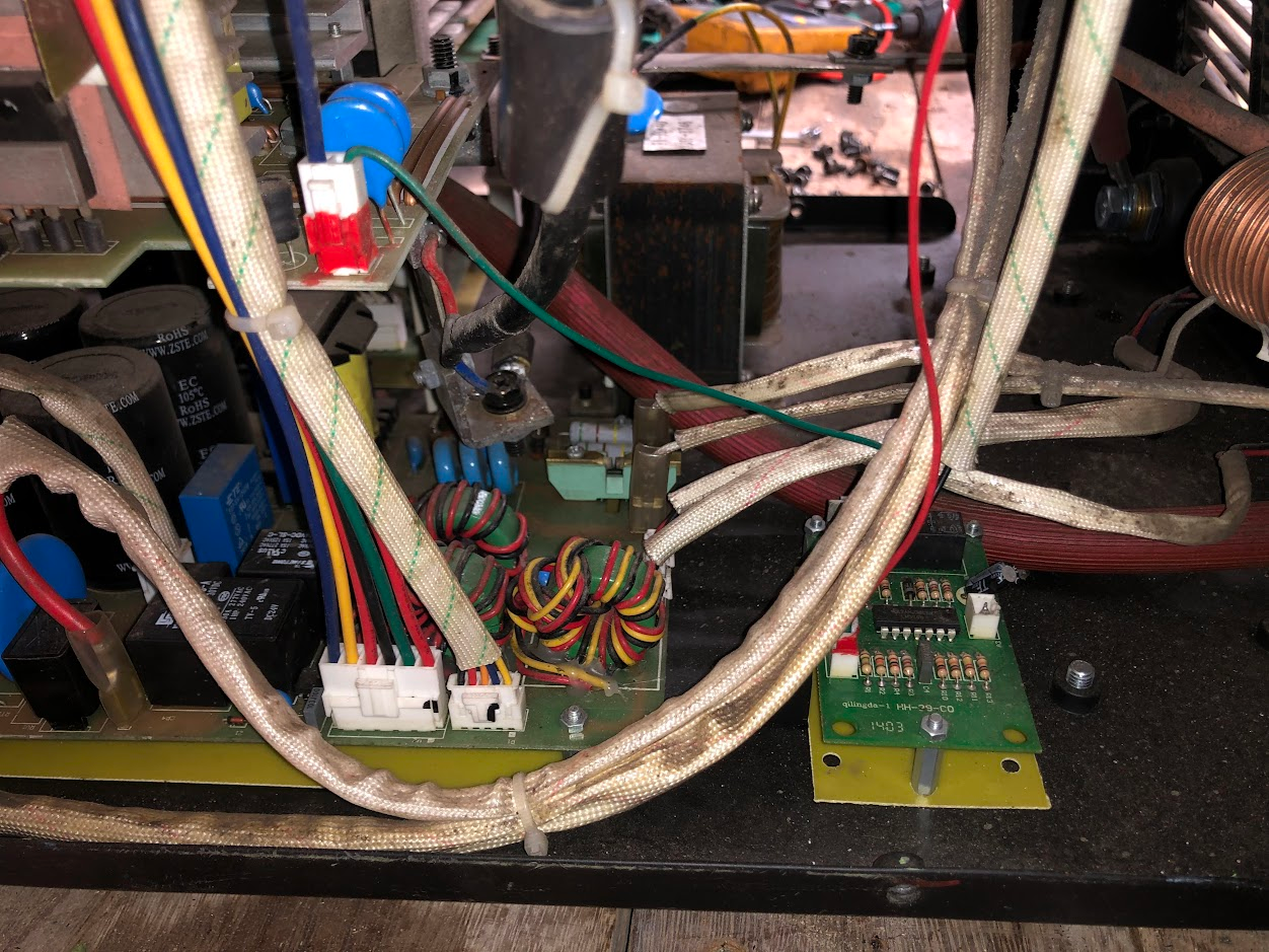

Opening it up doesnt reveal much. there is no obvious burnt components. My next steps are to test the ARC (mma) welding when I receive the lead, and to remove and inspect the board shown on the bottom left below (the one with the spark gap):
As the wires from the control lead socket terminate at this board, I assume that the issue is with this board. I will check the relays and the continuity of semiconductors for shorts.
SIP do seem to stock replacement boards on their website, but I would like to see if I can find the issue myself first, or at the very least , confirm which board as the issue first.
