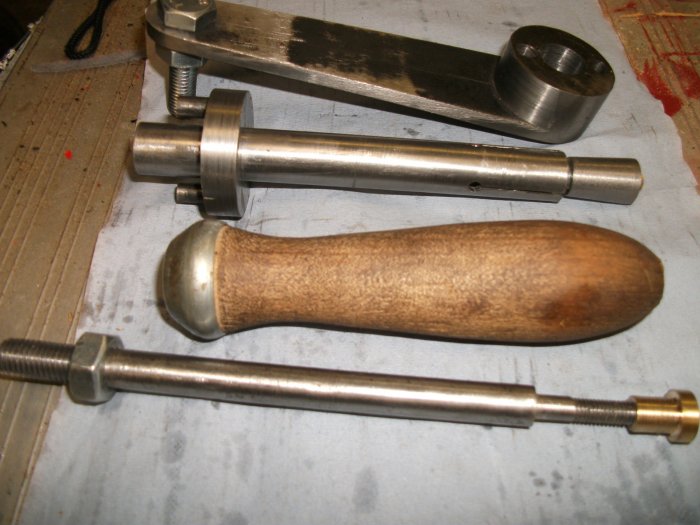

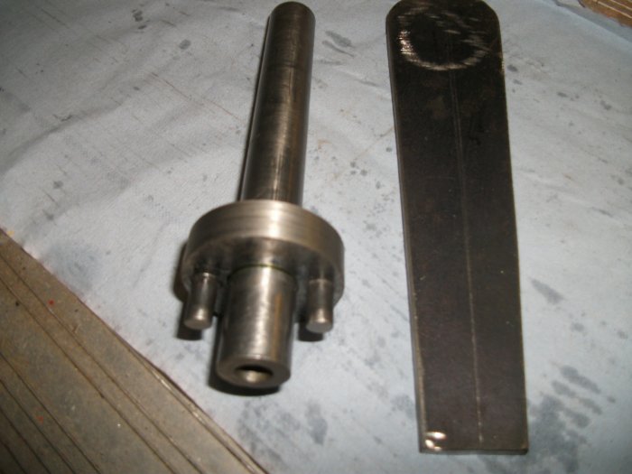

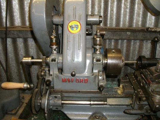

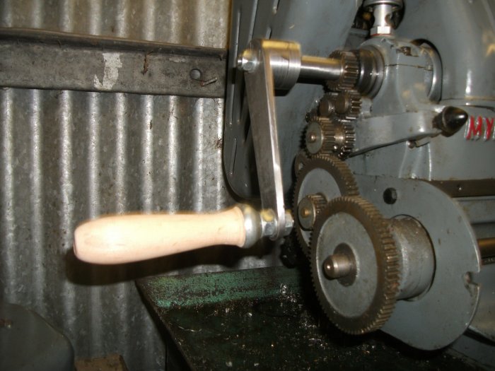

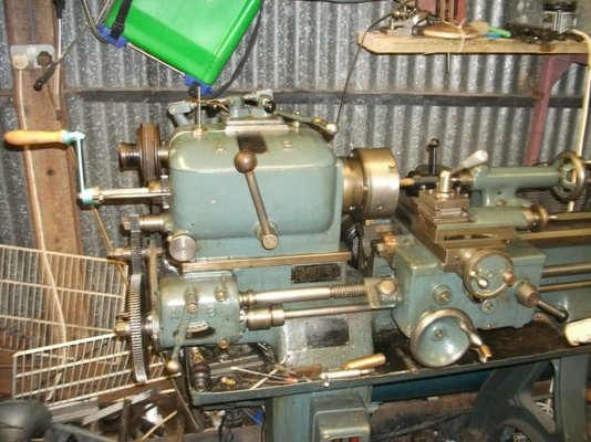

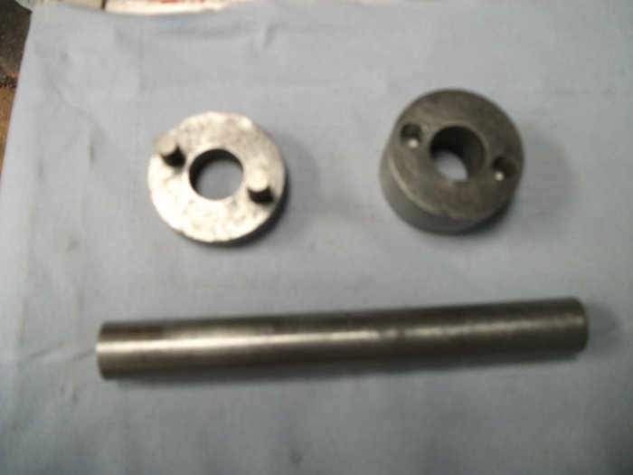

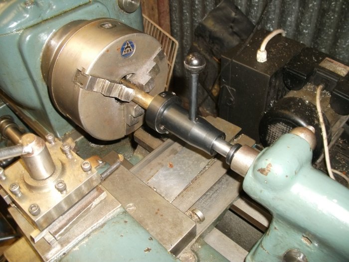

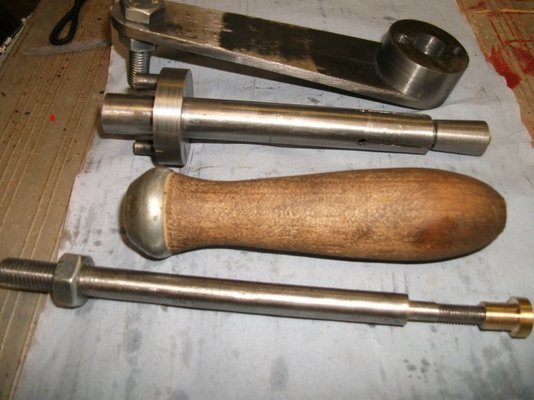

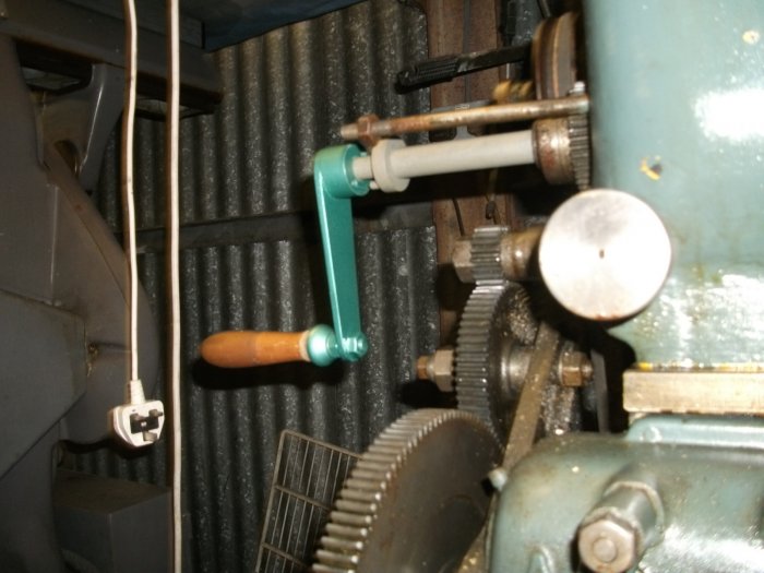

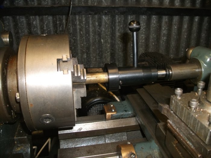

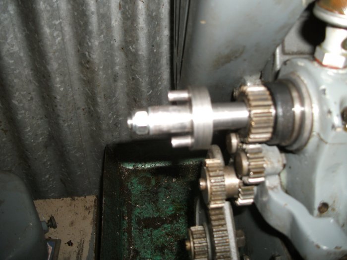

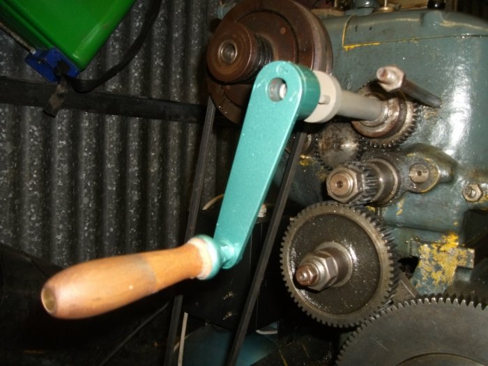

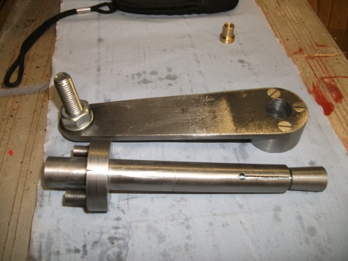

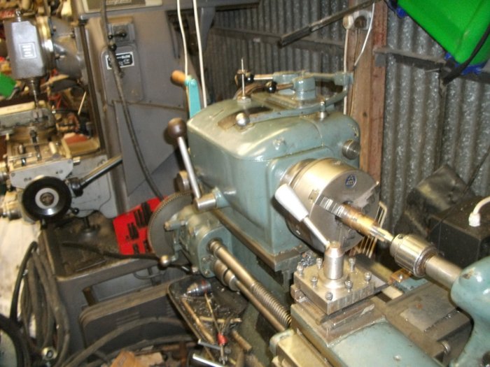

after spending a night taking the lathe motor to bits to rewire it for my new chinese reversing switch when it arives
i decided to make a hand cranked attachment for tapping its quick and saves having to reverse the motor all the time the shaft is slid in to the headstock mainshaft and is then nipped up tight on a taper simlar to a rawlbolt. the handle is removable so that the machine can be run without having to take the device out every time its not needed in conjunction with the tailstock die holder it makes the machine a lot more usable threading a lot of parts at once
