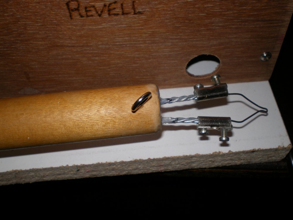

The wire tip at the end of the torch is ~ 1.5" of 26awg nichrome wire. at 2.5 ohms/foot I make that to be about 0.31 Ohms. The colour is cherry red indicating about 900'c...
I found a table on wiki;
http://en.wikipedia.org/wiki/Nichrome
Current (A) vs. temperature characteristics, straight wire.
This states that to get a piece of 26awg nichrome to 900'c it requires ~ 6.5A.
So I need a DC power supply capable of 6.5A through a load of 0.31ohms. so Vout would be 6.5x0.31 = 2V, however it might be nice to have some head room in the circuit so I can use a larger tip. 23awg would probably be ample so;
23awg @ 1.3 ohms/foot. 0.16ohms per 1.5" (length of wire tip)
23awg @900'C needs 9A. 9A x 0.16 = 1.4V.

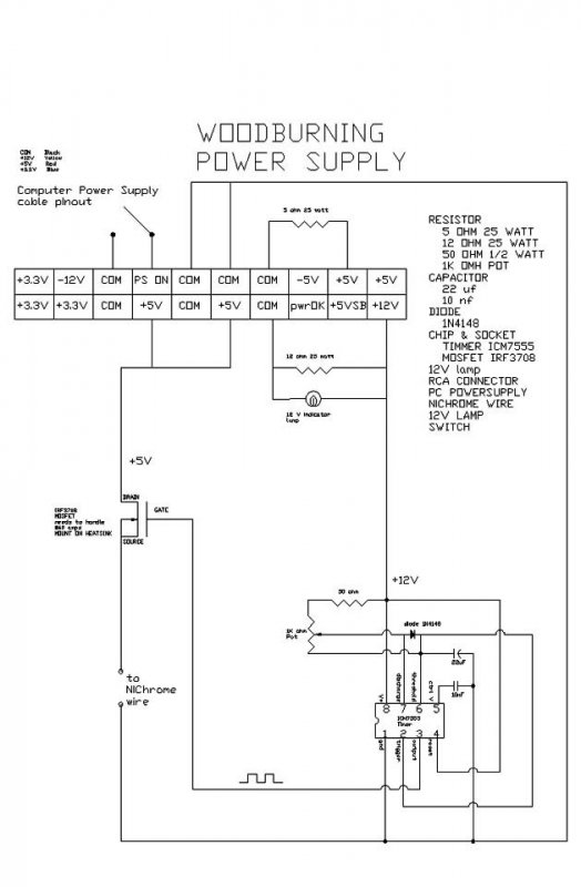

My plan was to use a 12v dc power supply to drive a DC to DC converter.
DC - DC converter something like this I thought would be suitable.
http://docs-europe.electrocomponents...6b80af7cf3.pdf
The info of the datsheet that interested me was;
Iout= 10A
Vout is adjustable from 1.2V to 5.5V
short circuit protection is auto reset @ 20A.
So I figured if I hooked up a pot to adjust the output voltage this would adjust the output current and hence control the temperature of the wire tip.
Can anyone tell me if this will work. I have concerns that I the DC converter wont work as I expect it...
thanks, Will.
