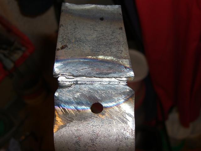

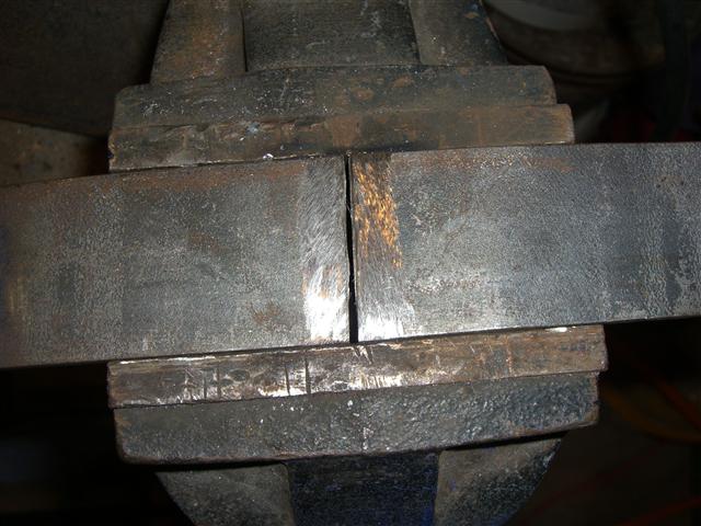

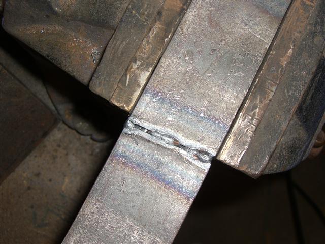

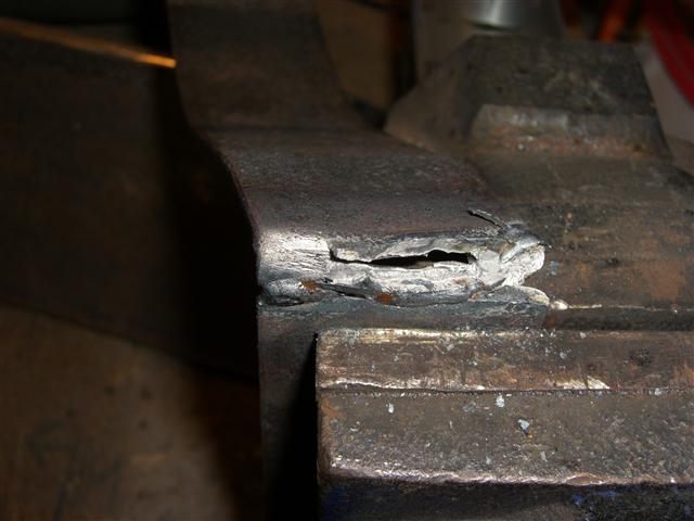

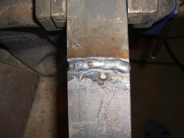

I have been doing a bit of practice today and one of my tests was to take some 30x3mm flat bar.. Cut it, join it with weld and then test the strength.
I left a couple of mm's gap between the 2 pieces and welded on one side..
When I turned it over there wasn't 100% penetration, but the weld looked sound..
I put the bar in a vice and bent it back and forth aggressively, and the entire bar bent, rather than the weld.. But when I moved the bar down in the vice so that the weld was just above the jaws and then bent the bar, I finally managed to "rip" the weld.
I then did another test by welding BOTH sides and the joint was perfectly sound.
Is this what you would expect of welding on side of a bar? Or do I still need to work on my technique.
I hope that you can follow my question.. But if needs be, I will repeat the test and post a few pictures.
I look forwards to your thoughts
