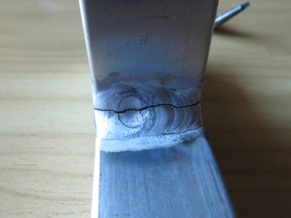

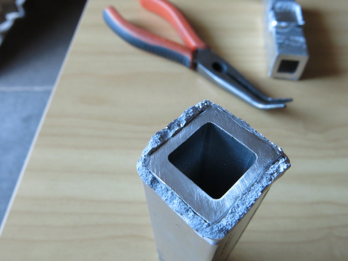

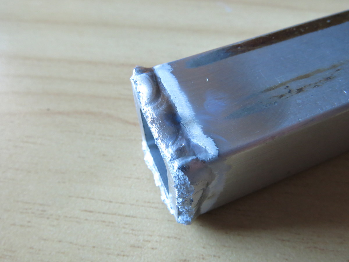

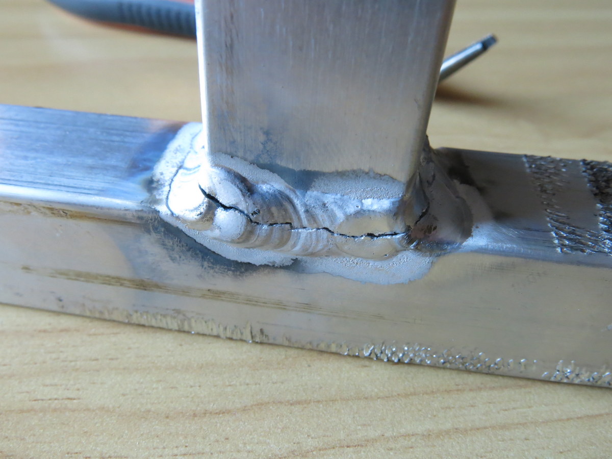

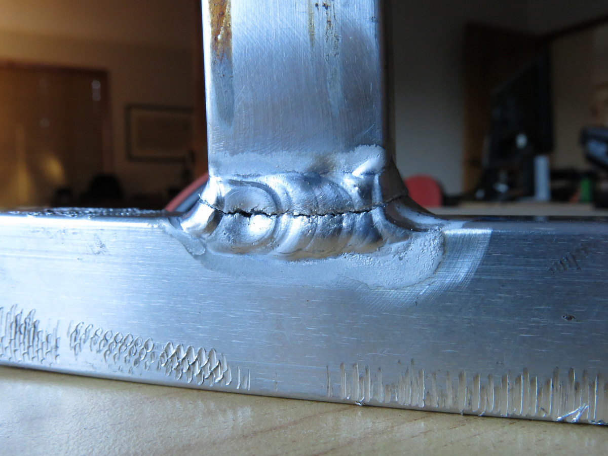

For some time I have noticed I'm not getting full penetration on aluminum tube.
The settings;
200+Amps AC, 25% Cleaning (or 75, Kempii is backward here), 120Hz rounded squarewave.
12 LPM Argon, electrode 2% lanthanated 2.4mm. Filler Rod 4043, cleaned of course.
Aluminum is 6261 - slightly stronger version of 6061. Cleaned. Tube is 25 x 5mm.
The side faces were bevelled, the fillet joint not. I've tried gapped, bevelled, plain, plain gapped. All the same.
Yes - I did have a little oopsie and dipped the electrode. The electrode is running OK, tip kinda rounded, purple when cooled. The puddle looks OK, no cracks post weld. Some small bubbles in the weld after "disassembly".
The problem is that when I had to take some frames apart I noticed the penetration wasn't very deep. To get them apart you have to beat the daylights out of it ie. it's not really lacking strength. By day lights I mean big vise, 4lb hammer, many strikes.
Any thoughts ?
