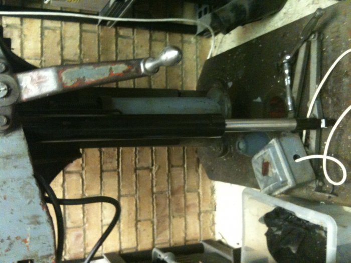

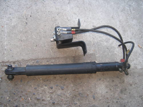

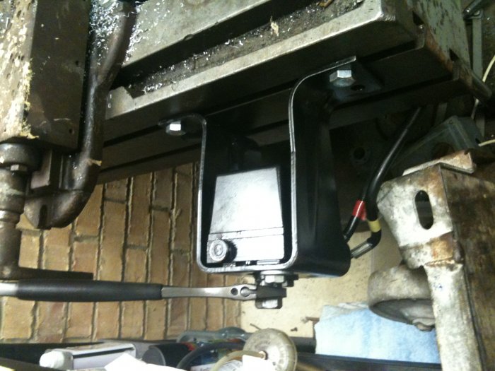

I have just bought a cab tilt pump and ram off of ebay:
The yellow labelled pipe had a t-piece and a cut off hose, the seller said this went to another ram, I suspect it may have done that or gone to a hydraulic lock mechanism for the cab. I removed the t-piece and screwed the hose directly to the ram.
The pump has a selector for up / down. It does not work how I thought it did! Turned one way, it pumped up, turned the other it retracted for a few strokes and stopped. Removing the filler cap made a hiss, and you could retract it for a few more strokes, then it would only move if you put the filler cap back on, and so on...
The pump pumps fluid out of ONE port, or BOTH ports, this is correct from a diagram I found of this sort of pump. It's not one or the other, so that can't be a normal double acting ram...
I played by connecting the single outlet (when selected that way via a single pipe to one port on the ram, it went up. I connected it to the other port on the ram, it made a funny noise and fluid slowly ran out of the other port, it didn't move.
Now whichever way I connect the hoses the ram goes up! I must have ******ed it up completely now. So how does that damn ram work and what's wrong here, I must be missing something, the ram must have valves or something in it? I must have killed a seal or something by playing as well hence it just going up now?
Help!
